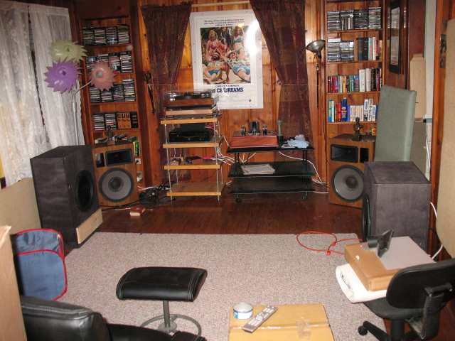

I have the 2 subs I used in the cottage last year but stored them away because of their size and now having neighbors in my current townhouse.
As you can see, it's a tough room, just 12x15
index.php?t=getfile&id=208&private=0
index.php?t=getfile&id=209&private=0
No corner on the right but at least the bicycle helps with diffraction Very Happy
I'm thinking about spending for some lower end 10" Dayton subs and building 1.5 cu ft boxes, then running them just above the edge of audibility. That worked well with the big subs in the cottage
index.php?t=getfile&id=211&private=0
I just have to resist the temptation to TURN IT UP for the Organ Symphony http://i242.photobucket.com/albums/ff258/truckthis/emoticons/thbig_rotflol.gif

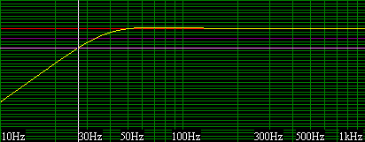

Upon further review, just as with the big ugly black subs, a sealed cabinet and the 15" Dayton DCS-380s I have on hand give me a nice plot in 3Pi-sized boxes 20" on a side.
index.php?t=getfile&id=212&private=0
Should be a good'n easy summer project. I also have a pair of plate amps so won't have to fool around with those lovely, but teeny-tiny parts crossovers you mentioned.
