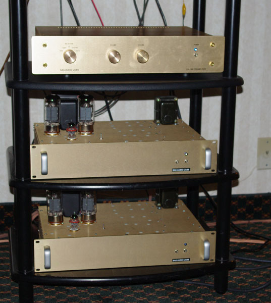

ps. Here is a picture of test amps from the 2009 AKfest using KT88s, before I changed the design to EL-156s.
index.php?t=getfile&id=233&private=0

The photo is being updated. The 11A Reference Line Preamplifier is in a new Aluminum chassis and knobs. The Monoblock chassis are also to be in the same aluminum chassis, for a matching look.
The file is too large, so I will provide a link.
http://www.sasaudiolabs.com/picture5.htm
