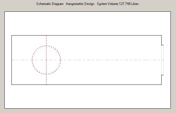

I switched to a non-MS OS long ago and have not been able to run the sheets (they were simpler and even then I needed hand-holding). I was poking at hornresp (runs in wine) to try to find some modes but I admit to not ever trying this kind of geometry in there so I need more work to even trust what I think I'm doing (let alone the validity). Fumbling in the dark.
I can do pieces, but not the whole thing with proper driver and port locations. Haven't been able to nail the Z humps you posted elsewhere, either. Pretty sure I might be misapplying this model, too (but I'm having a sort of "fun" Wink

It looks cool, that's for sure. You just gotta test it to see where those peaks fall, either with computer models and sims or cut-and-try physical models and measurements, or both.

Well, at my skill level, I'm counting the first two honks and not going high-order.
I mean, to state the obvious, making the volume into anything other than what you designed makes it something else so the question is what makes sense (no answer here, yet). I don't pretend to be making the same thing but more trying to save the most of a good thing while still fitting something into the guy's house.
The Helmholtz is cool, and to radically paraphrase you, a tall skinny box is gonna have modes and they'll need attention...and damping...and care locating port and driver.
