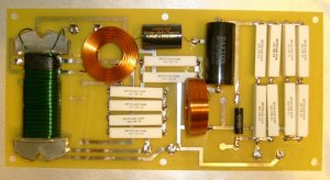

I think it is the new crossover, but not sure how to tell...It is a very thick silver trace on a beige board with upright connectors.
Re: pi 7 plans and answers [message #62356 is a reply to message #62355] Thu, 15 April 2010 13:39 Go to previous message
Does it look like this?
http://www.pispeakers.com/catalog/images/Pi_Crossover.jpg
If so, it's the new crossover. To make it into a seven π crossover, remove a coil and a couple of caps, and add another coil. It will look like this:
http://www.pispeakers.com/catalog/images/Pi7_Crossover.jpg
Is yours a standard crossover, or does it have upgrades? The standard crossover has 18 guage coils and Dayton, Solen or Jantzen cross-caps. It can optionally be built with 15 guage coils or high-end capacitors like Auricaps.
In any case, you can swap parts from one to make the other. Alternatively, you can send your crossovers to us and we'd be happy to modify them for a small fee.
