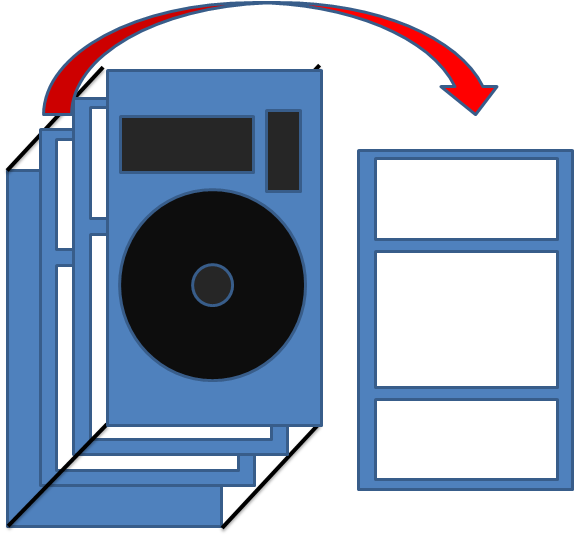

I've been in communication with Wayne for a couple days trying to determine what I should build for my HT. Looks like I have settled of 3 4 Pi speakers (2 normal and 1 sealed for center channel).
To build the three enclosures it looks like I will need 2 sheets of plywood. My local wood source has 3/4" Cabinet Grade Birch Plywood - 11Ply - on sale for $59.75 per sheet. This stock is " A-1 domestic made plywood" and seems high quality. However, he also has 13-ply Baltic Birch for $92.25 per sheet. I am trying to keep the cabinet costs down, but don't want an inferior product as a result.
I will have enough scrap material to extensively brace the cabinets (see attachment for a rudimentary diagram).
I appreciate any advice on any part of the project.
SWNindex.php?t=getfile&id=157&private=0
VIRIBUS MARI VICTORIA

I would hope that you post some progress reports/pictures of this project. A couple thoughts came to mind as I reviewed your plan and contemplate my own.
Was your decision to go with the modified center speaker based on aesthetics or something else?
I wonder if there is a point at which putting a lot of internal bracing in as you show starts altering the internal volume of the enclosure.
Re: 4 Pi build for HT [message #62170 is a reply to message #62166] Wed, 24 March 2010 10:25 Go to previous messageGo to next message
I'd love to see NWCgrad's build pics too. As for the internal bracing, yes, of course, if you displace too much internal volume you can affect performance. So the obvious reply is "don't". It is designed to have an internal cross-brace and that's plenty. On the other hand, using a window brace is fine too and takes no more volume.
It will be summer before I can start to build, I am on temporary assignment away from home for the next few months.
I am going with the modified center based on aesthetics - I do not plan on building grills so I liked the symetrical approach.
