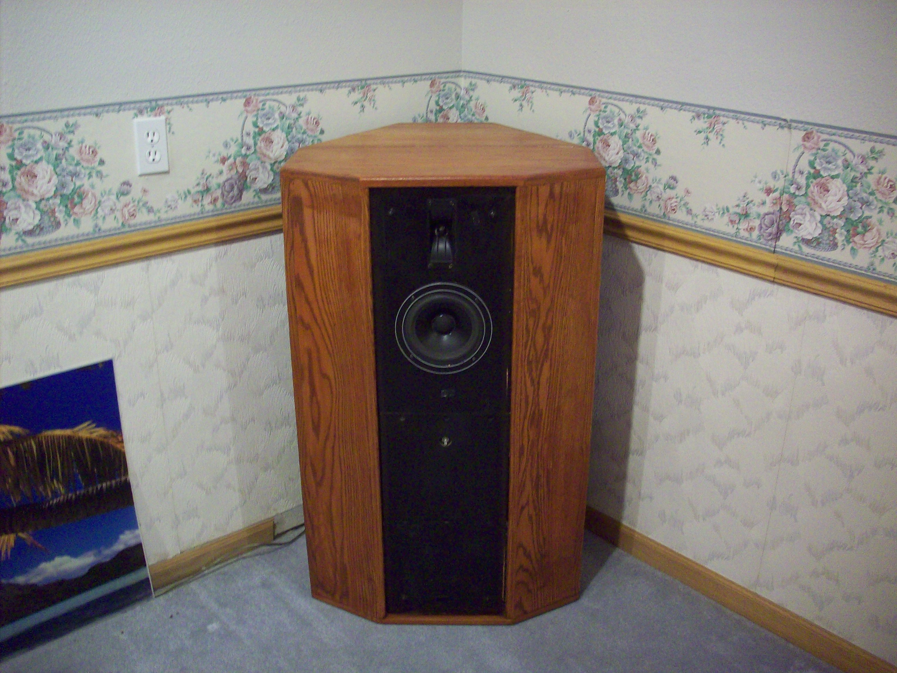

I'm new to the forum, first post. I have a pair of Speakerlab Corner Horns that I got from a kind gentleman last summer.
He said they were about 20 years old. They were in pretty rough shape, paint splatters and all so I refinished them with my limited talent and put new surrounds on the mid's.
Does anyone know anything about them, were they considered ok at the time, etc.?
Thanks in advance.
Mark
index.php?t=getfile&id=166&private=0
index.php?t=getfile&id=167&private=0
index.php?t=getfile&id=168&private=0

Re: Speakerlab Corner Horns [message #62167 is a reply to message #62164] Wed, 24 March 2010 10:08 Go to previous messageGo to next message
Those are very attractive speakers, congratulations!
I believe the cabinet is a clone of the Klipsch cornerhorn. There have been some discussions about it here, some I think even include plans. Here's a link to search results:

But of course - those are the latest and last version of the Speakerlab "K", circa 1980's.
The bass bin is essentially a Klipschorn knockoff. The midrange is a 7" direct radiator and an EV 350 on the "super" model (or T35). If the midrange driver is 16 Ohms, you could go stock Klipsch after market with ALK crossovers, I think that the ALK "Universal" handles 16 or 8 Ohm midranges intechangably anf its set up for a Khorn, now if the woofer is an 8 Ohm driver, you will need a different (non-stock) version.
I've attached a couple of files on the Speakerlab.
