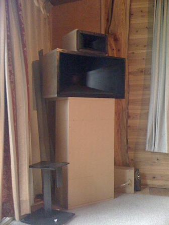

Re: 4 Pi and 7 Pi bass response- More similar or different? [message #63089 is a reply to message #61567] Mon, 07 June 2010 20:19 Go to previous messageGo to next message
Messages: 75
'You want it? You got it!' (from The Kills Keep on Your Mean Side 2003.)
Crappy photo to camoflauge nasty MDF:

Re: 4 Pi and 7 Pi bass response- More similar or different? [message #63090 is a reply to message #63089] Mon, 07 June 2010 21:01 Go to previous messageGo to next message
Nice, looks great! Gonna veneer or paint?
