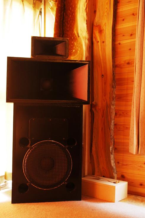

I saw this thread and had a couple questions. For HT use would there be any benefit using the Pi7's over the Pi4? I won't be using any cornerhorns. Unfortunately, I don't have that option right now. I saw this pic and thought it was really cool:
index.php?t=getfile&id=140&private=0
Could the Pi7 work with a forward firing woofer section? I know the JBL has nice midrange though so I am unsure. I don't want to complicate my build anymore than it needs to be but if there are benefits I'd like to know.

Re: 4 Pi and 7 Pi bass response- More similar or different? [message #62114 is a reply to message #61567] Tue, 16 March 2010 18:29 Go to previous messageGo to previous message
If you have the right corners, then sure, seven π cornerhorns are better, definitely.
They have two big advantages, first is the corner sets the pattern constant all the way down in frequency, clear down to the Schroeder frequency. This is where room modes begin to take over, making pockets that sort of overrule the launch directivity. Standing waves within the room modify the wavefront that would have existed outdoors or in a very large room. But from about 150Hz up, the cornerhorn makes a pattern with constant directivity, and I know of no other configuration that can do this. The second advantage is you split up the mids and bass, which improves IMD and also gives some smoothing of the upper modal region.
So if you have the right corners, use them. But if you don't, the DI-matched speakers are very close, especially when combined with multiple subwoofers. More info at the link below:
