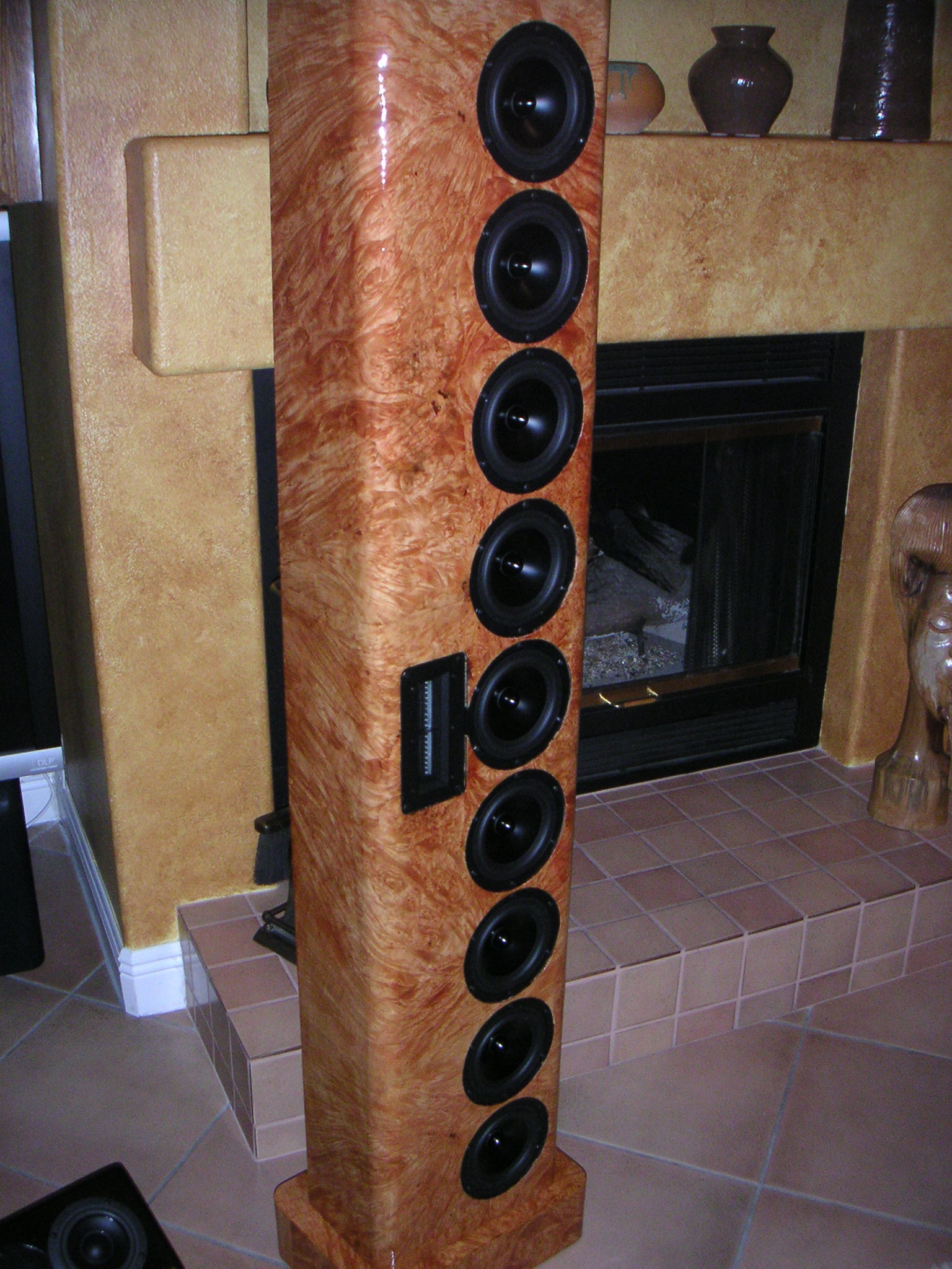

I couldnt afford high quality drivers with two full lines so I had Rick Craig at selah design me a set which he coined the DayTek. they consisted of the 6" dayton RS and a single fountek jp2. I loved these speakers for a long time. When I was seated on the couch watching movies or listening to music they were phenomenal. When I stood up or had parties and was walking around it was clear that the single tweeter just dropped like a rock. The high end just fell off the face of the earth and it started to but me.

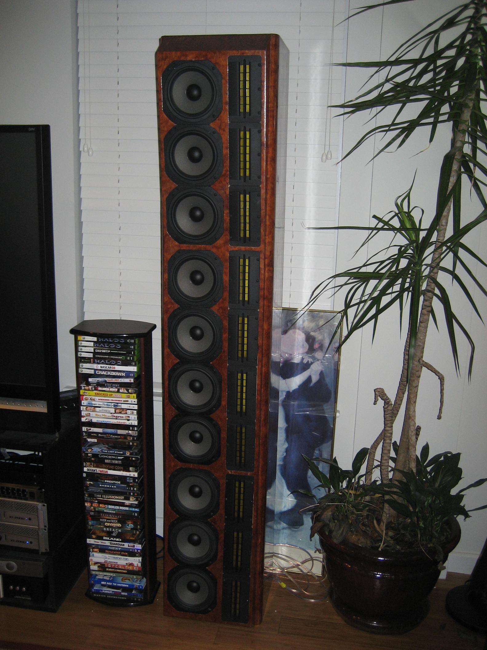

So then after having those for a few years I decided to spend some money and built a set of semi focused full line arrays with focal 6.5" and dayton pt2C. I use a behringer dcx2496 and 2 crown xti2000s to power them. I use soundeasy and true rta for my measurements. this is my current system and I love it. solves all the problems with the single tweeter.

Long story short. If you are going to be sitting ALL the time go with the single tweeter and you will be content. If you will be using them at any point where you will be standing or walking around have a line of tweeters covering minimum of sitting to standing dimensions if you cant afford to do a full line.
