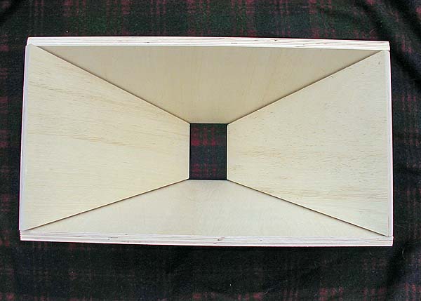

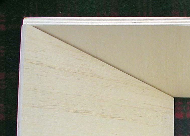

Re: 4 Pi and 7 Pi bass response- More similar or different? [message #61622 is a reply to message #61576] Mon, 28 December 2009 13:00 Go to previous messageGo to next message
Messages: 56
Registered: December 2009
Location: Texas
Hi Wayne,
I did a rough build of a midhorn, to get a perspective on its size, and to see if I ran into any problems. I just made it with butt joints, using 0.75 in plywood. The butt joints don't meet flat, I guess because of the flare of the horn. I used the dimensions from the link I posted a few replies up. Does the full 7pi plans have more detailed construction of the midhorns? If so, I may need them.
Also, I will probably buy 7pi crossovers from you, but wanted to know what is the crossover point between the woofer and midhorn?
Here are 2 pics of my rough build midhorn.
Thanks,
Tom
index.php?t=getfile&id=130&private=0
index.php?t=getfile&id=131&private=0
  • Attachment: horn01.jpg
    (Size: 51.73KB, Downloaded 8046 times)
  • Attachment: horn02.jpg
    (Size: 57.48KB, Downloaded 7922 times)
Re: 4 Pi and 7 Pi bass response- More similar or different? [message #61624 is a reply to message #61622] Mon, 28 December 2009 13:10 Go to previous messageGo to next message
You're right about the butt joints, obviously you'd need to angle them if you wanted the edges flush with the throat plate. However, what you've done is fine, especially for a one-off build. Just assemble the horn with PL adhesive which expands to fill in the gap. Find a way to clamp it together while the adhesive sets up and then afterwards, file the seam of hardened glue to make the throat nice. Be sure the throat area is 4.5" square too.

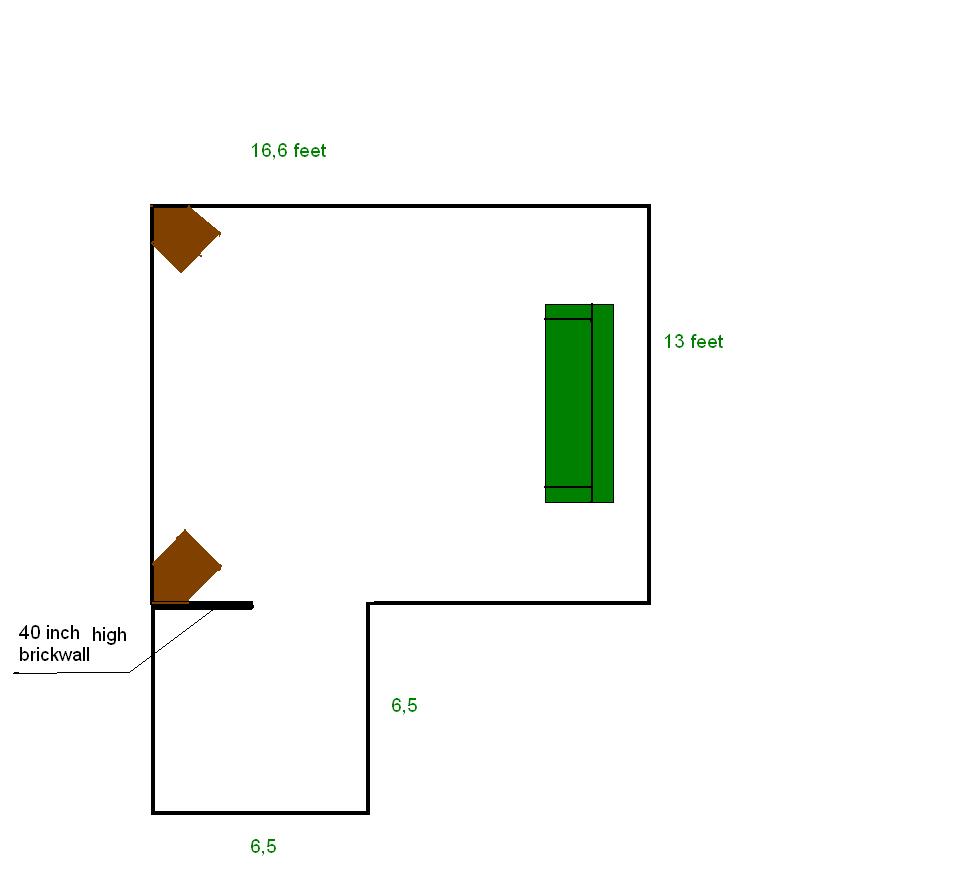

Re: 4 Pi and 7 Pi bass response- More similar or different? [message #61627 is a reply to message #61618] Mon, 28 December 2009 14:56 Go to previous messageGo to previous message
feket663 is currently offline  feket663
Messages: 28
Registered: August 2009
Location: Hungary
Wayne Parham wrote on Mon, 28 December 2009 00:52
The room size isn't the problem, I don't think. I would prefer them along the short wall though. If you don't have two good corners at each end of that wall, I would probably keep the four π speakers instead. You can put them just about anywhere.
Here is my room's schematic. Is this good place for the 7PI?
I do not want to put boxes on the opposite side of the room, because there is not enough the bass. I think the little part of room reduce the bass.
index.php?t=getfile&id=132&private=0
Sorry for quality...
