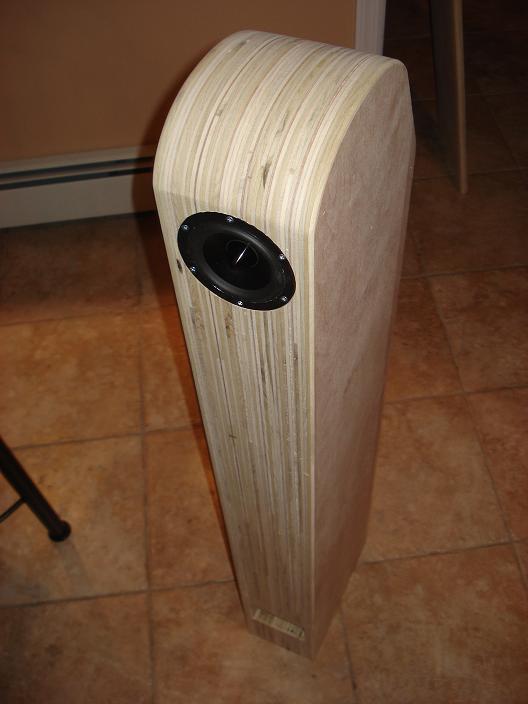

Made some headway on the speakers over the past two days. The New York snow storm gave me the push I needed to get started. Ive got them assembled and running, just need to finish them. My first impression was "WOW, There is actually some bass coming out of these." After the initial shock, I was disappointing with the upper frequency range. I haven't tuned the line yet. I imagine some dampening will clear that up some. Attached are some pictures of the construction process.

These were a gift for my brother for Christmas. The intention was to start him off on a surround sound system. Over the next gift giving opportunities I'll add the remaining speakers. These speakers are starting as fronts for a 2.1 setup but will become great rears later on.
For his first impression, I had my brother close his eyes while I played a vocal jazz track for him. Halfway through I had him open his eyes and he was completely surprised. He told me that he had envisioned two large floor-standing speakers and two small speakers hanging in the top front corners.
I couldn't have been more happy with his description. That was exactly what I was going for. I wanted a full sound with a broad sound-stage from a relatively simple package.
They could be brighter. Maybe they will become more agile as they break in.

Today I compared these speakers to the ESSs in the picture. Renaissance music with harpsichord seemed to not compete with the crisp treble of the Heil driver. But the speakers seem to excel with vocal jazz and other "small" music platforms. My impression is that they out perform the heils in this format. The vocal performer seems to come forward of the sound-stage while the ESSs appear to be a broad but still two dimensional. I believe this is due to an excess of midrange. This isn't necessarily a bad thing but it does limit style of music.
