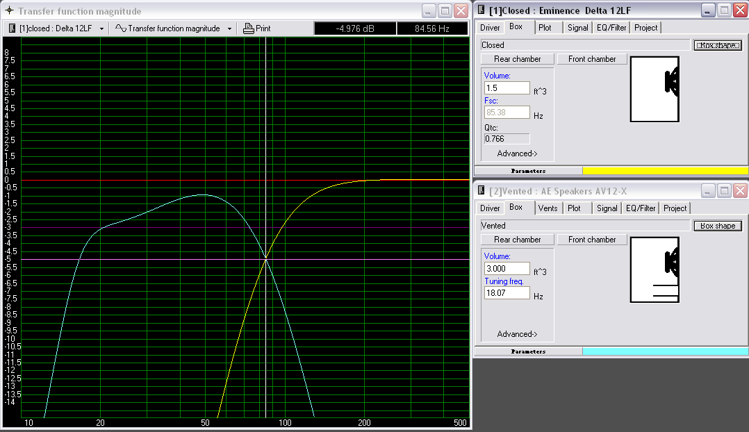

I'm thinking about building a set of 3Pi speakers into 1.5cu.ft sealed boxes to use for HT and music. The Delta-12LFA models very well sealed, giving an almost ideal 2nd-order roll off @ 80hz (THX standard). They will be stand mounted (horn center @ 34") and placed directly against a wall. The baffles will be 14" wide. I'm wondering if there are any glaring problems with this idea. I understand there is no baffle-step compensation in the crossover and I the speakers should be close enough to quarter-space to make it unnecessary (I think?).
The logic for this is to achieve an acceptable WAF while retaining most of the advantages of a large two-way (I just love good horn systems!). I attached the WinISD sim (shown with subwooder and THX crossover in place) and a Sketchup image of my concept. I'd appreciate any feedback you might have!

I understand your desire to make the cabinets smaller. That's a worthy goal. And I think what you've described is probably pretty safe. However, I want to mention that you're not looking for crossover between subs and mains when used indoors, at least not in the traditonal sense. What you want is overlap, in this case, because you want multiple sound sources in the modal range.
One of the most important things for getting smooth, uniform bass indoors is having multiple sound sources below ~100Hz, positioned at different places in the room. For best sound quality, you really don't want to have just one sub covering this range.

I've heard of the Multisub concept before, and I guess I need to break old HT habits. I think I can find a way (with my receiver) to let the tops run full range. This will at least give me -6db @ 60hz. I know I can't have my cake and eat it too (great bass AND small enclosures) so this is one of the compromises I'll have to make. I could EQ a little more extension in - at the expense of headroom.
