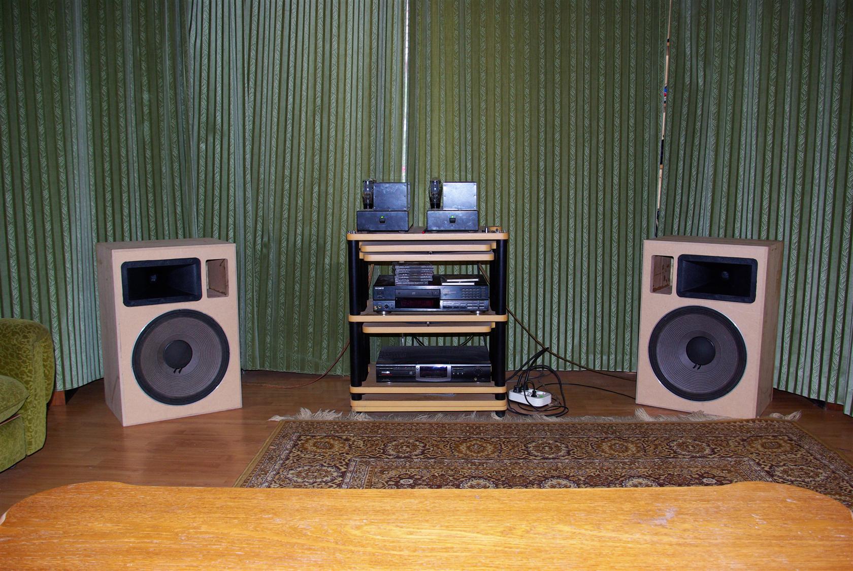

Dear Wayne! My 4PI speakers nearly complete. Here's a picture of them.

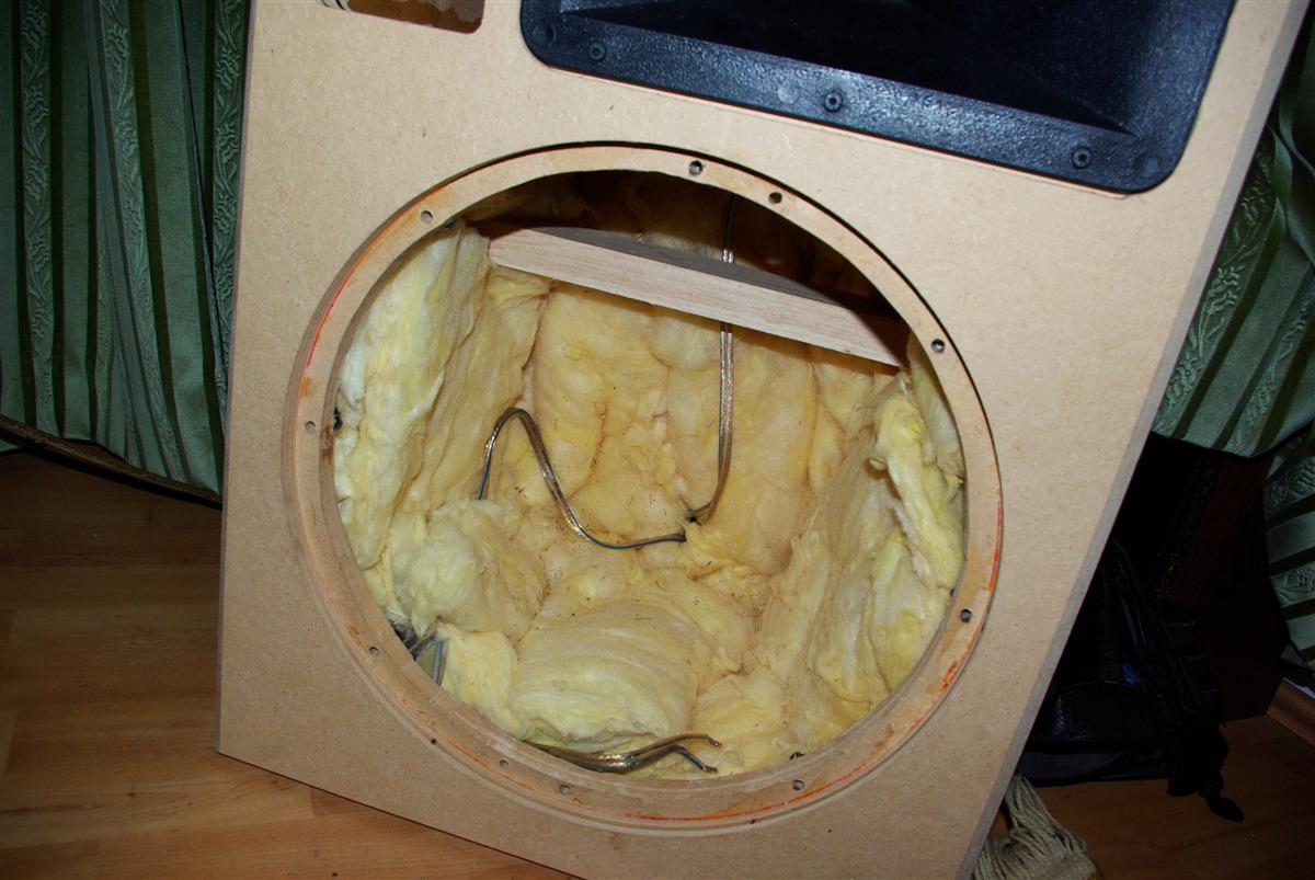

A single question is even: The damping material (about 3 inch thick fiberglass insulation material) is enough, too much or too small quantity?index.php?t=getfile&id=84&private=0
I listened a lot, but I think a bass response a bit wawy. A deep bass is ok, but the 60-70 hz range is a slightly less. This can occur when an inadequate amount of damping material?
Can you send me a pic of 4PI's inside with damping material?
Thanks for help!

Looks good. You put in the right amount of damping material, from what I can see.
How long have you had those woofers? I ask because 2226 woofers tend to be pretty stiff out of the box. They're underdamped at first. The alignment shifts to where it is supposed to be after several hours at moderate power. You can move some woofers back and forth by hand to do this "break in" process, but I prefer to let the motor do it for me.

Wayne! Thanks the fastr reply. The woofer is used, I think it's over the break-in procedure.
