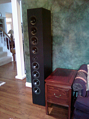

Re: One enclosure glued up! [message #61368 is a reply to message #61360] Fri, 13 November 2009 07:06 Go to previous messageGo to next message
dbishopbliss is currently offline  dbishopbliss
Messages: 10
Here is a cell phone photo of one cabinet completed
index.php?t=getfile&id=99&private=0
Re: One enclosure glued up! [message #61369 is a reply to message #61368] Fri, 13 November 2009 09:22 Go to previous messageGo to next message
Very nice looking!
