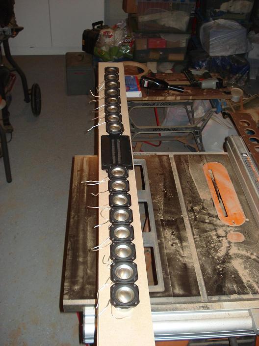

Before I go and build the big lines, I wand to modify these. My goal is to stick a Dayton PT2C-8 in the middle of the curved arrays. This will eliminate the combing. Now I need some sort of crossover. I would like to have a separate high-pass for the tweeter and a low-pass for the line. This would allow me to bi-amp. This will also allow me to match the volume of tweeter to the line. I'd like it to be as steep a slope as possible at 5k. A 4th order crossover satisfies that criteria. I found a calculator online at:
http://www.apicsllc.com/apics/Misc/filter2.html#fourth
The values it gave me are not available. How close of a tolerance should there be on the components?

Second iteration. Two-way, bi-amped, 24db passive crossover at 5khz, and curved for time alignment.

Adding the tweeter doesn't eliminate the comb filtering, especially with a 5K crossover point.

To find where the basic level of comb filter distortion starts, you divide the distance of the speakers in inches from the speed of sound in inches per second. This gives you the frequency where comb filter distortion may start. For example 13560 inches per second/3.5 inches center-to-center = 3874 hz. In this example comb filter distortion will start at 3874hz, and you really can't cross your 3.5 inch center to center midranges much above 3874. If your mid ranges were 5.25 c-to-c, then it would be 13560/5.25= 2582hz, where your cross can't come in higher than 2582.
The center to center distance between your mid ranges can't be any further apart than 2.75 inches to cross at 5000hz. and you would do well to remember that the distance between the highest mid in the lower group and the lowest mid in the higher group is way above that number.
Your planar needs to go on the side of the mid line array. However I've seen a lot of arrays, including Fred's ART array that put a tweeter in the center between the two smaller lines. I don't know what this does.
All this said, I'm not 100% sure how much you can hear comb filter distortion, as long as you sit in one spots and don't move your ears vertically.

my 2" peerless fullranges have a ctc of 2.17. Combe filter starts at 6260. I thought having the ribbon take the high freqs at 5k would make the comb effect not noticable. Is it that im crossing too close?

If your c-to-c on the mids is only 2.17 then they will not comb filter at 5000, and the ribbons don't have that kind of problem.
Looks good then.... to me! Don't worry about comments from people who make cryptic statements and don't tell you why.
How low do those little fellows go for a two way? They look sort of like a 2 inch mid range dome. PE makes one of those and they don't go lower than about 400hz
I don't think that the distance between the two portions of the mid range array are an issue but is there wa reason why you didn't make the baffle wider and put the tweeter on the side?
