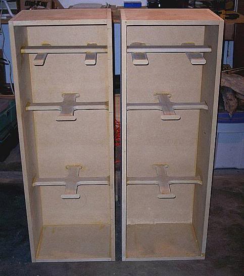

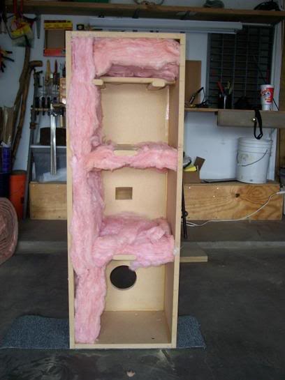

Re: 2-Pi tower bracing [message #61094 is a reply to message #60995] Tue, 29 September 2009 16:23 Go to previous messageGo to next message
Messages: 1117
Wayne-o wrote on Wed, 23 September 2009 17:50
Does the 2x3 bracing go horiz. or vertical or put another way, if you look down the box from the top is the bracing 3 inches across or 2 inches across ? Thanks.
Wayne-o, here is what I did with mine, FWIW.
index.php?t=getfile&id=74&private=0index.php?t=getfile&id=75&private=0
Re: 2-Pi tower bracing [message #61136 is a reply to message #60995] Fri, 02 October 2009 21:28 Go to previous message
Messages: 225
Thanks for the Pix.
