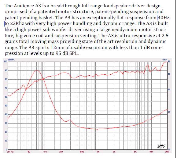

Audience has taken an interesting approach to the HF issue by designing their own 3" fullrange A3 driver(.pdf spec sheet). Their arrays are complemented by subwoofers for the bottom octaves.
Anyway, their A3 drivers have a natural 3-5 dB rise between 1.5kHz and 7kHz, above that it is +5-15dB out to 20kHz. They supposedly run their arrays fullrange w/o any crossover. And the drivers are 85dB/16ohm w/ 12mm of excursion.
My question is if the natural HF rise in their A3 compensates for comb filtering effects as a result of c-to-c distances?

Re: Fitting line arrays together [message #60824 is a reply to message #60823] Thu, 10 September 2009 15:52 Go to previous messageGo to next message
Marlboro
Messages: 403
If the rise was able to compensate for comb filter distortion, then there would be no such thing as comb filter distortion in any real scenario since all anyone would have to do is connect an equalizer to the system and produce a rise.
