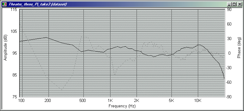

Do you have a spl/freq chart on the three-Pi with the D12lfa ? I am more interested in tone than a perfectly flat response, so the variations in the the woofer make a big difference in the tone, even when it is as small as one Db . Thanks
Re: Pi-three freq. response [message #60422 is a reply to message #60421] Sat, 18 July 2009 13:24 Go to previous messageGo to next message
Messages: 19102
I have an on-axis response chart of the three π loudspeaker with Delta 12LF and PSD2002, but it's an old one measured pseudo-anechoically with Speaker Workshop. When I have time, I'll make a set of measurements outdoors with LMS. Until then, here is the Speaker Workshop chart:
http://www.pispeakers.com/Measurements/Theater_three_Pi_take3.gif
