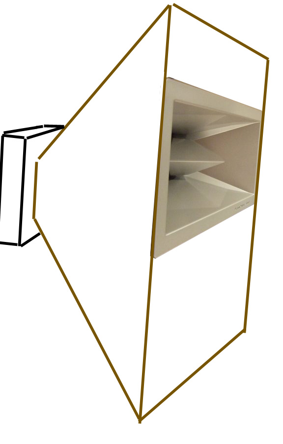

...and to mount the the Res1.5 midhigh COAXIALLY, in the center of the big horns. Remember, the mid high mouth is 16" x 8", the mibass mouth is 22" x 22". Is this a GOOD IDEA? The question is will the midhigh create a shadow, or block the sound of themidbass driver and horn. It it worth emulating a single point source or will the drawbacks be to great?
Attaching a sketch of my concept. Will the directivity difference at 500 Hz cause a problem?

what do you think about my coaxial "horn within the horn" sketch? It's attached to the post.
The small horn would be mounted in the big horn. If crossed at 500 to 600 Hz would it work? dispersion problems happening here?
Theoretically, the midbass horn would be 18" wide, like the high horn, but tall, about 35" high, coupled to the low ceiling of my basement.

Coaxials have never held my fascination because they solve one problem by causing another that I think is worse. Whatever you do in a coaxial arrangement, something is compromised. Usually the inner horn is too small, and suffers poor loading and pattern control. This gives ripples on and off-axis. If the inner horn is made large enough, it tends to obstruct the outer horn, leaving a hole in the pattern on-axis. Some configurations have been used that pack a driver or array of drivers along the side walls, but this creates multiple reflections and even in its best trim, it's really hard to get the summing right. Any shifts cause whatever alignment is provided cold to be misaligned hot. So none of these kinds of coaxial or coentrant arrangements are very attractive to me.
There is one thing that a coaxial or coentrant horn does well, one problem it solves. There is no vertical offset between the sound sources. So if you need a tall vertical pattern, you have the possibility to get one using a speaker arrangement like this. The thing is, I can't see much use for a tall vertical pattern and the price you pay to get it takes that option off the table for me. But if you need tall vertical coverage, it might be useful. It also makes for nice convenient packaging.

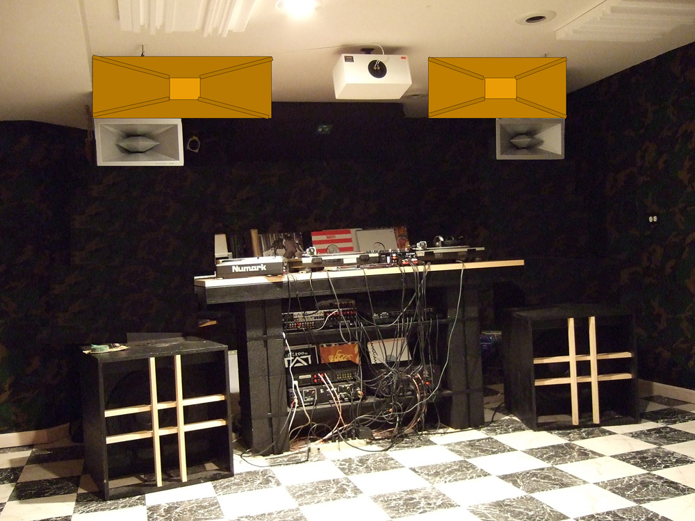

While trying to figure out HornResp, I came up with two midbass horn layouts. The question is weather they will work in my setup, so I included both sketches.
1. Midbass ABOVE the midhigh, coupled to the ceiling: available area: 12"x34" mouth, 30" depth.
(option1.jpg)

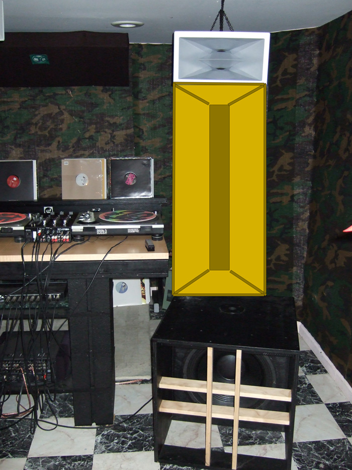

2. Midbass VERTICAL, below the midhigh. I was inspired by this JBL horn:
http://www.jbl.com/home/products/product_detail.aspx?prod=1400%20ARRAY%20BG&Language=ENG&Country=US&Region=USA&cat=BFS&ser=PTS
Can this be made to cover 90 deg horiz x 25 deg vert? By stretching out the throat to be tall and narrow?
(option2.jpg)
index.php?t=getfile&id=39&private=0

Re: Two midbass horn layouts... [message #59565 is a reply to message #59563] Tue, 30 June 2009 22:02 Go to previous messageGo to next message
There are a lot of ways to skin a cat. But as for me, I try to keep the sound sources above the Schroeder frequency spaced so they sum constructively through a fairly large vertical arc which means relatively tight vertical spacing. The crossover should be designed with the same goal, to provide a large forward lobe with widely spaced vertical nulls. Naturally, you want to have the same horizontal coverage from each sound source so directivity and spectral balance is uniform along the horizontal plane. I say naturally, but I guess that isn't a given. That's just one of my priorities.
Below the Schroeder frequency, the sound sources can be (read that should be) spread out a little more to smooth out the room modes. So I guess my vote would be to use a midrange that blended with your woofer in the upper modal region. Keep the woofer low-pass under the Schroeder frequency, but let the midrange run down as low as possible for good blending. You can't do that if power levels are high like for prosound, but in that case you probably wouldn't have room modes to contend with so the tradeoffs would be different. For home hifi and home theater, I think it's a good way to go.

Re: Two midbass horn layouts... [message #59567 is a reply to message #59566] Tue, 30 June 2009 22:18 Go to previous messageGo to next message
I would not choose the option with the mids and tweeters near the ceiling and the woofer on the floor. I'd prefer the mids and tweeter down closer to the woofer, with a fairly wide overlap and smooth blend between woofer and midrange. The second option with the tall mid source - something like a line array - might be a good option. You could do this with a line of drivers perhaps. But in that case, I might be also tempted to use a line of tweeters instead of a point source.
Naturally, my way of doring this is what I've done in my six π and seven π loudspeakers. In those, the woofer and midhorn have a wide overlap to smooth the upper modal region. The midhorn and tweeter are tightly coupled to provide good summing over a 90°x40° pattern. You could always scale up the midhorn if you wanted. Larger horns tend to provide acoustic loading and pattern control down to a lower frequency. The only thing to watch out for is that you don't also reduce the upper frequencies or make it too large to give good verticals. There are lots of competing priorities to balance.

I would go with your 2nd option. Like Wayne said " The second option with the tall mid source - something like a line array - might be a good option."
I use 8 - 6.5" drivers, operating at 100-2.3kHz in a 55" line array for p.a. for mids, the drivrs are Dayton's from Parts Express, and they run pretty much flat, what ever room I put them in.
