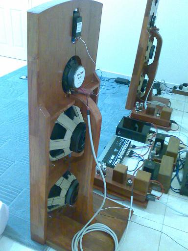

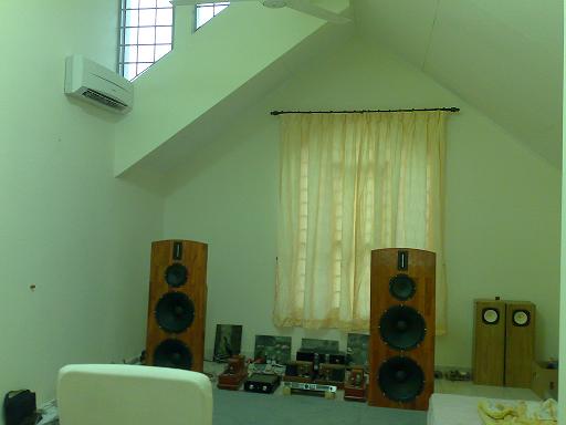

I just completed an open baffle project. But it doesn't sound right. Especially some prominent echo on the mid high freq and mid high freq is quite bright.
My baffle dimension is 20" x 52", with 2" thickness. The configuration on each side is:
1 pc Fountek NeoCD2.0 Ribbon Tweeter
1 pc Visaton B200
2pcs Eminence Delta 15A
I'm using Behringer DCX2496 active crossover, running 2 ways, tweeter & B200 1 way coupled by capacitor of 1.22uF & 2pcs Delta another way.
Attached photos for your reference.
Would like to ask what type of crossover to use, which order, what freq to cross at & other essential setting to look at?
Or is it due to other factors, like driver or room?
Need advice.
Thanks.
