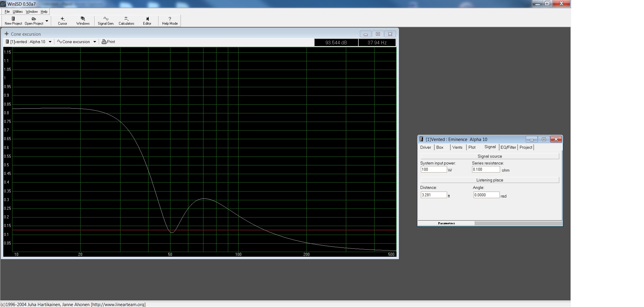

I'm a winisd/modeling newbie, for the 2pi towers I am seeing xmax at only 2.2W input, while its posted here we can send 100W through the passband Rolling Eyes . What am I doing wrong?
Inputs:
Alignment: tried all of them (what is the correct one, EBS?)
Volume: 129 liters
Port dia: 11.43 cm
Port length: 1.59 cm
Re: Alpha 10 modeling [message #70520 is a reply to message #70519] Tue, 20 December 2011 13:51 Go to previous messageGo to next message
Make sure you are band-limiting when you check the numbers. If you look at the mechanical limits below 30Hz or so, they're very small because the cone is unloaded below the Helmholtz frequency. Also check the easy (but easy to miss) stuff like metric verses imperial and make sure you aren't off by a decimal point.
What you should see is thermal limits exceeding mechanical limits except below the Helmholtz frequency. There's a range just above Helmholtz where the mechanical limits dip, but they never dip below 100 watts anywhere in the passband (above 35Hz). Below the passband, the limit is mechanical and can be reached with little input because the cone is unloaded. From 35Hz to 50Hz, excursion is greatly reduced and so the limit is thermal. In between about 50Hz and 60Hz, the two limits (mechanical and thermal) are very close to the same. Above 70Hz the limit is thermal.

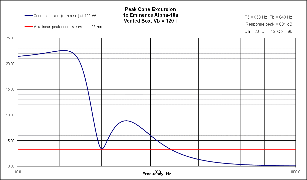

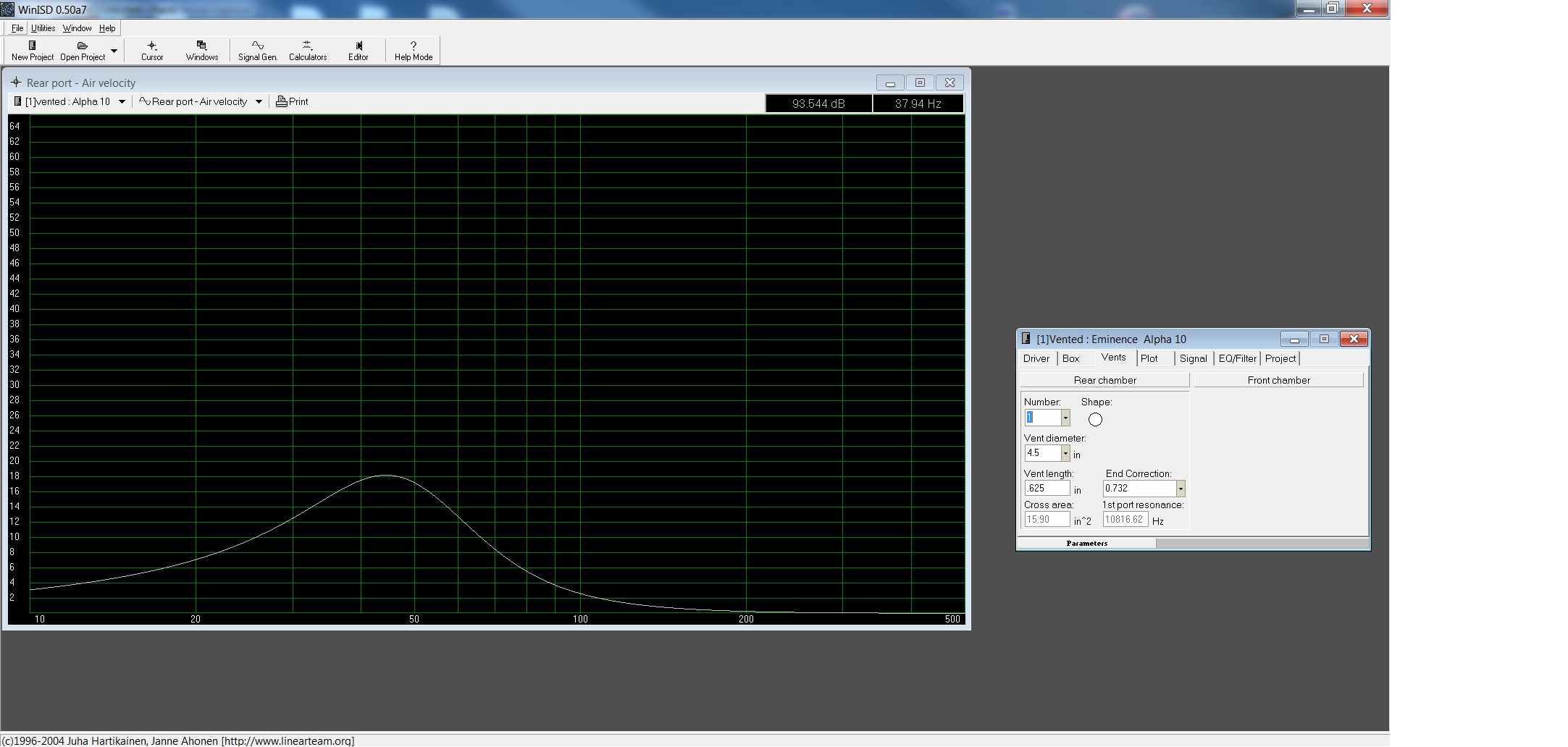

Thanks for the thermal/mechanical explanation. My winisd modeling follows the expected responses you outlined, except that xmax appears to be exceeded. Or is xlim the value we are trying to stay under?
Not doubting, just trying to learn modeling vs. real world. I've checked and rechecked the input numbers and just can't get it straight. Even more confusing is I have modeled several other woofer/subwoofer designs, and all of them were pretty much spot on modeled vs. real world (using xmax as the mechanical limit, I assume to avoid high distortion values).
Please take a look at the attachments, maybe you can see where I am going wrong. Thanks!

Re: Alpha 10 modeling [message #70523 is a reply to message #70522] Tue, 20 December 2011 17:00 Go to previous messageGo to next message
It looks like your red line is around 1.25mm, yes? But xmax of the Alpha 10 is 3.2mm and xlim is 9.1mm.
You can check this with distortion measurements, if you like. It stays low in the passband, and rises below it. All through the passband, distortion stays low at power levels under 100 watts. As power is increased to 100 watts and above, distortion rises around ~60Hz, as excursion begins to become excessive in that region. So the models track well with measurements.
One other thing: The Helmholtz frequency is 40Hz, not 50Hz. If you make this change in your computer model, it will be more representative of the behavior of the physical device. Your response curve will change from being slightly underdamped (humped, as shown in your simulation) to slightly overdamped, (flat, no hump) and a bit gentler rolloff than max-flat. Just an FYI.
Re: Alpha 10 modeling [message #70524 is a reply to message #70523] Tue, 20 December 2011 18:03 Go to previous messageGo to next message
Messages: 58
Registered: February 2011
The graph is in imperial units, xmax = 0.126in ~ 3.2mm.
I have played with the default tuning winisd calculates after providing box size/port dia/port length to 40Hz. This change shows 8.86mm cone excursion @ 60Hz (still way over xmax).
I am going to give unibox a whirl and see what happens.
Re: Alpha 10 modeling [message #70525 is a reply to message #70524] Tue, 20 December 2011 18:09 Go to previous messageGo to next message
Now that you've changed fb (the Helmholtz frequency), I think you probably have a pretty good model, although I think you're interpreting the charts overly cautiously. I'm tempering my interpretation of the simulations with what I know from the distortion measurements. Excursion does go over xmax around 60Hz (but nowhere near xlim), and distortion at that point is just breaking double digits. It doesn't get anywhere close to damaging the driver at 100 watts, and while distortion is higher between 50-60Hz, it doesn't become severe at those power levels.
