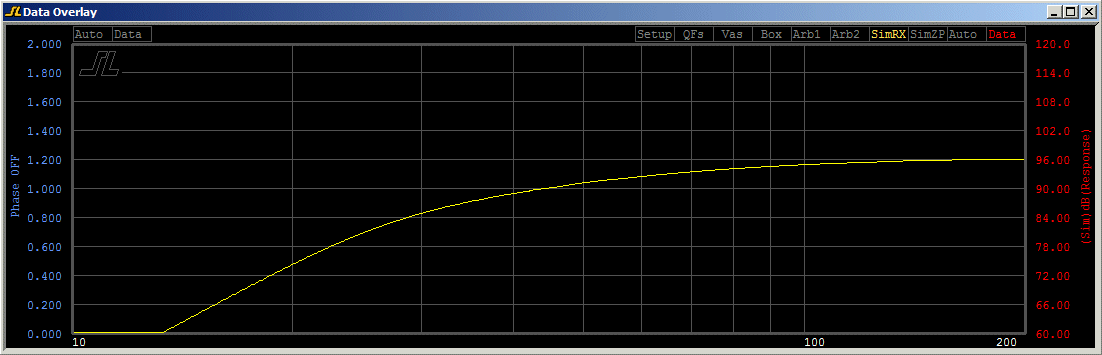

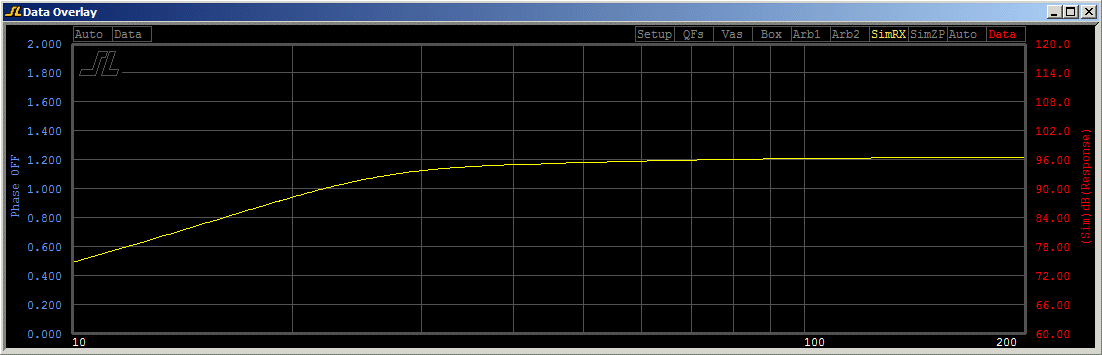

The seven π bass bin is overdamped so it conjugates nicely with the bass lift from room gain and corner loading.
See the charts below. The first one is the response of the cabinet if it were placed in free space. It is overdamped and has a gradual rolloff curve. It needs to have a curve like this because lower frequencies below the modal region tend to pressurize the room rather than develop standing waves. This causes bass boost and would make the speaker to sound boomy if it didn't have this resonse curve. The second curve shows response with room gain.

Bass response without room gain

Bass response including room gain
