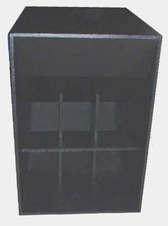

I'm thinking the 12π basshorn subwoofer may be a bit much. It was designed for outdoor use or very large arenas and is overkill for home hifi. But if you want the most powerful, lowest distortion and highest fidelity possible, it's the sub for you.

The 12pi is one I am considering, but it only appears to go down to about 30Hz. Can the horn be modified along with different speakers to reach into the 10Hz range? What about an IB speaker set up? Does an IB rattle everything in your attic?

No, the 12π is not suitable for use under 30Hz. I wouldn't recommend any horn for use at the frequencies you're talking about. I suggest a large driver with low Fs, or more likely several of them. For use at infrasonic bass frequencies, you really need low resonance and high displacement. Infinite baffle mounted in a wall or ceiling would probably be a good way to go.

I like that servo drive system. It's a true servo system (using feedback) rather than just a name. Without some mechanism to reduce distortion, subwoofer distortion is usually high double digits or even triple digits. The 12π hornsub reduces distortion using push-pull drive. Horn loading also reduces distortion and makes it capable of very high output, 105dB/W and 138dB max output. Other good subs reduce distortion with shorting rings or differential drive. Without some mechanism to reduce distortion, subs can really sound flabby to me.
