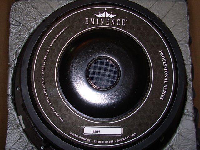

Mesh in cooling vent

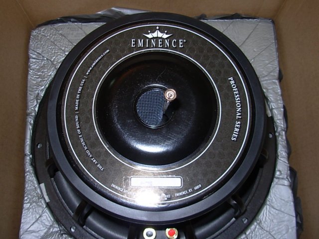

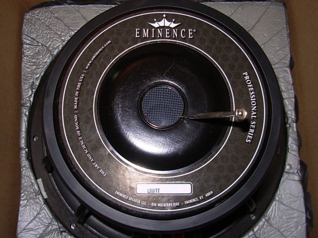

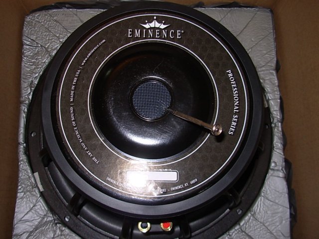

The first thing is to remove the protective mesh in the cooling vent. It is pressed in, and comes out quite easily. Use a jeweler's screwdriver, pick or nail to pry it out with. It doesn't take a lot of force to do; Some practically fall out.
Lift up on mesh
Pry out the mesh

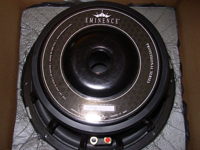

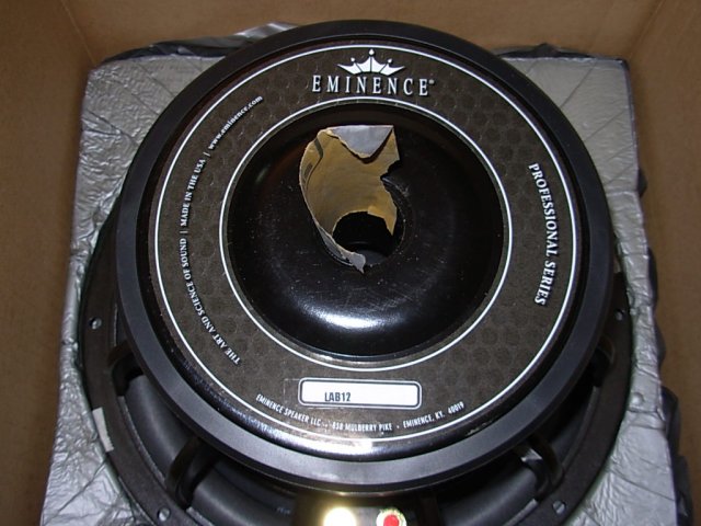

When the mesh is removed, you can see the inside vent. It is painted to prevent rust. The paint will act as a thermal resistance, so it is good to remove it and apply heat conductive grease instead. The grease will prevent rust and will provide better heat transfer from pole piece to cooling plug.
Mesh removed, showing vent interior

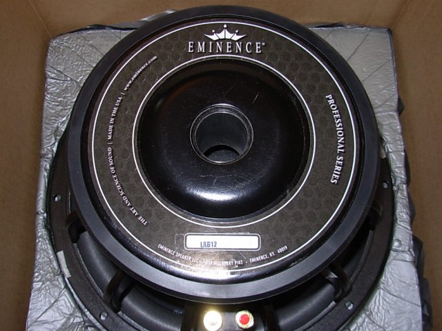

Use a piece of fine grit sandpaper, 400 to 600 grit. The best size is small enough to work with, but not so small it can easily fall into the vent. If it falls in, you will have a very difficult time getting it out. So I strongly suggest using a paper strip large enough it cannot fall into the vent; That way you won't worry about it.
Sandpaper to remove paint from vent

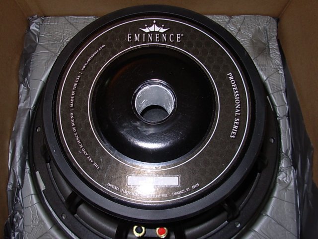

You don't have to sand long. All you want to do is to remove the paint, which just takes a few swipes. The paint dust will not hurt anything, but wipe it out with a cloth anyway. That way you can look into the vent and see that the metal is exposed on the whole surface.
Paint removed in vent exposing bare metal
