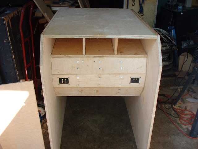

Seven panels surround the motor chamber, so now we trim and fit each one. We started with the the front piece and worked our way around the the back pieces.
http://www.pispeakers.com/Basshorn/Motor_Chamber_Back_Open.jpg
Motor chamber front piece and one of the rear pieces installed
http://www.pispeakers.com/Basshorn/Motor_Chamber_Back_Open_Side_View.jpg
Motor chamber side view, showing baffles
http://www.pispeakers.com/Basshorn/Motor_Chamber_Rear_Open.jpg
Motor chamber, almost finished
http://www.pispeakers.com/Basshorn/Motor_Chamber_Side.jpg
Completed motor chamber, side view
http://www.pispeakers.com/Basshorn/Motor_Chamber_Top.jpg
Motor chamber, top view - Notice connectors on rear panel

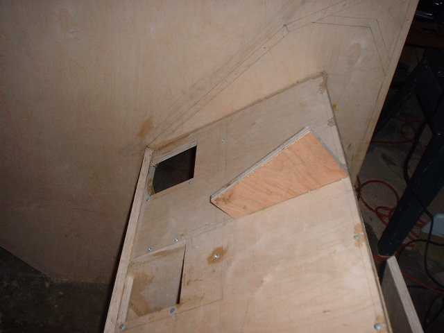

Next step is to add fill to the front chambers to displace some of the volume and reduce the size of the front chamber. Cut pieces and glue them in, using clamps where necessary.
http://www.pispeakers.com/Basshorn/Chamber_Fill_Clamped.jpg
Inserting fill pieces to reduce front chamber volume
http://www.pispeakers.com/Basshorn/Outer_Chamber_Fill.jpg
Outer chamber fill
Two pieces are installed on the outer front chamber that are not installed on the inner front chamber. This is due to the difference in widths of the front chambers, and it keeps the volume of each exactly the same. Notice the two pieces near the speaker connector terminal on the outer chamber are not present on the inner chamber.

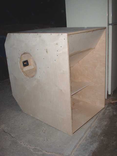

Now route the side panels so the access panel / heat exchanger can be installed flush. The panel is 1/4" thick, and a gasket is installed so route the edge 9/16" deep for a flush fit.
http://www.pispeakers.com/Basshorn/Side_Routing.jpg
Routing access panel hole
http://www.pispeakers.com/Basshorn/Side_Finished.jpg
Side panels with access panel hole routed

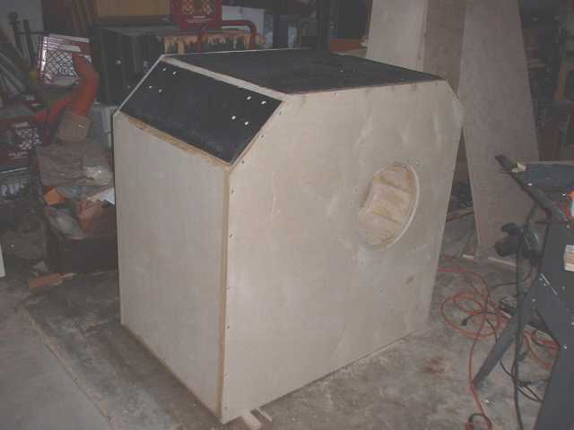

Re: 12 π basshorn - Coming together - Part 2 [message #47740 is a reply to message #47431] Sun, 18 September 2005 11:31 Go to previous messageGo to next message
Messages: 19102

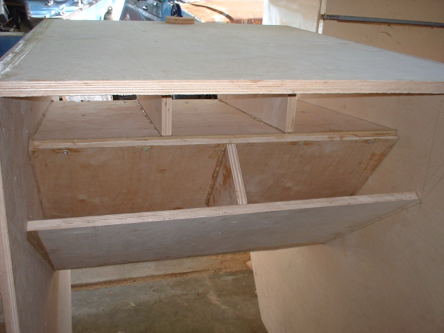

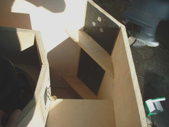

Now we build up the horn flare from the motor chamber outward. First, glue the throat panel brace in place. You might want to drill shallow holes and use a short 1/2" dowel section as a positioning pin.
http://www.pispeakers.com/Basshorn/Throat_Panel_Brace.jpg
Motor chamber and throat panel brace

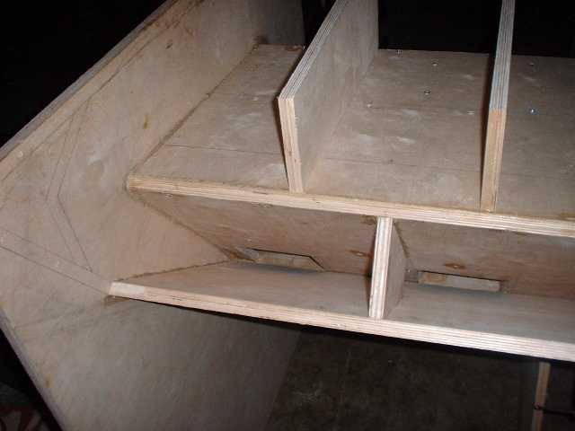

Attach the throat panel and the upper braces.
http://www.pispeakers.com/Basshorn/Throat_Expansion_And_Braces.jpg
Throat expansion and braces

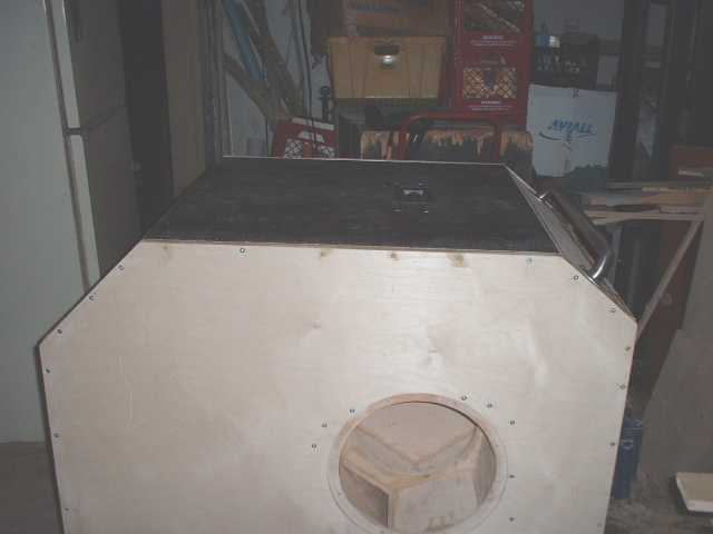

Attach the top and nose pieces. Both sides are attached to make sure fit is good. One side is glued and permanently attached, but the other side is only temporarily screwed in place.
http://www.pispeakers.com/Basshorn/Throat_Panel_and_Top.jpg
Throat panel and top
http://www.pispeakers.com/Basshorn/Rear_View_Motor_Chamber_Sides_and_Top.jpg
Rear view of motor chamber with sides and top attached

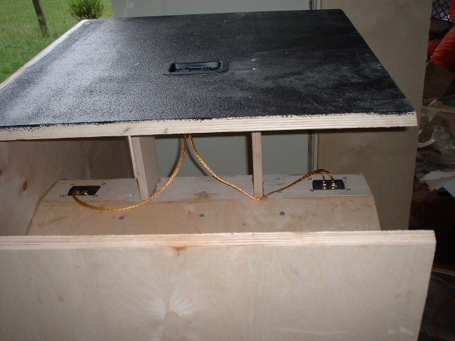

Prepare the back panel by cutting the connector panel hole and applying the finish coat. You won't want to paint after the panel is in place, so do it ahead of time. After it is dry, you can attach the back panel and connect the internal wiring. Notice the braces between motor chamber and back panel. Having the side mounted lets you check fit. This photo was taken after the back was already mounted and the side removed for easier access to horn internals.
http://www.pispeakers.com/Basshorn/Internal_Wiring.jpg
Internal wiring

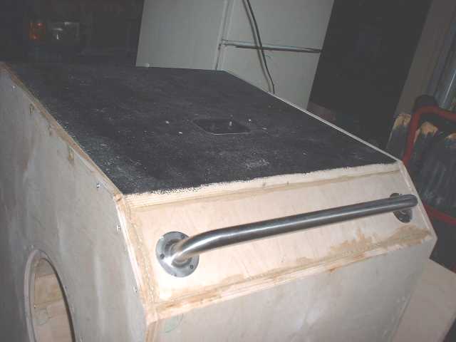

Similarly, the angled pieces in back must have their finish coat applied in advance. The top piece mounts a handle and the bottom piece mounts castor wheels. Notice the holes drilled for the castor wheels in the picture below.
http://www.pispeakers.com/Basshorn/Back_and_Bottom.jpg
Back and Bottom
Cut holes and insert T-Nuts to mount the handle. Here we've test fit the handle before removing it again to provide the finish coat.
http://www.pispeakers.com/Basshorn/Back_and_Top.jpg
Back and top
http://www.pispeakers.com/Basshorn/Back_and_Side.jpg
Back and side
http://www.pispeakers.com/Basshorn/Face_Down.jpg
Face down

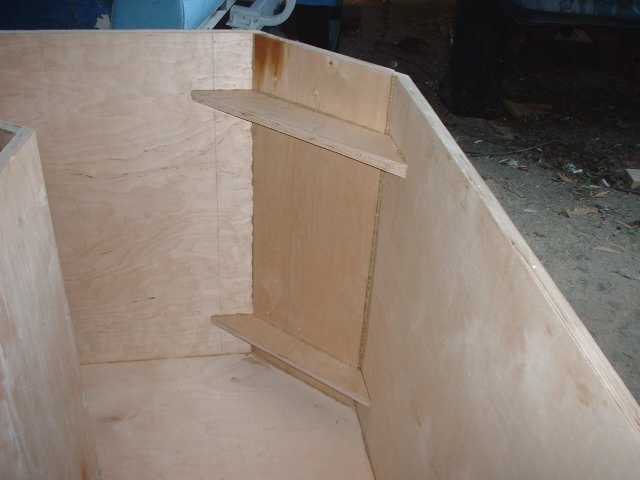

Attach braces for the diagonal pieces, both top and bottom. The bottom ones should be placed immediately above the castor wheels, to provide strength in this area. The braces on the top panel should be placed near the handle mounts to provide extra strength too. Mount the wheels and handle.
http://www.pispeakers.com/Basshorn/Bottom_Corner_Brace.jpg
Bottom corner braces
http://www.pispeakers.com/Basshorn/Top_Corner_Brace.jpg
Top corner braces
Add the braces for the mouth area, and then attach the side. Glue them in place and the horn is finished, ready for painting.

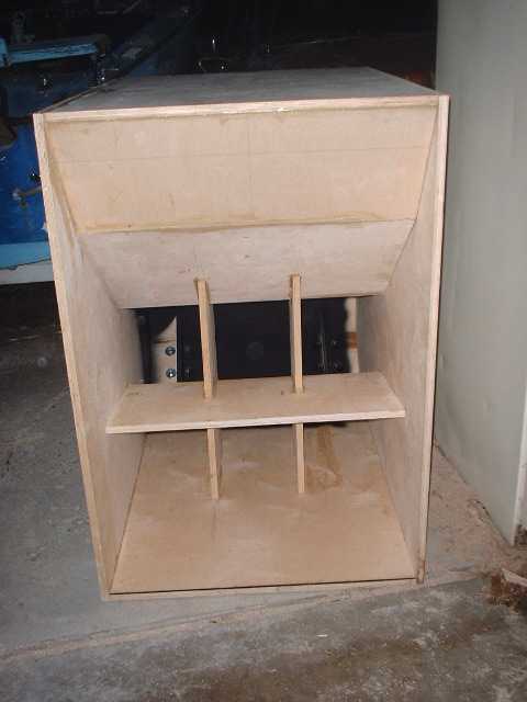

http://www.pispeakers.com/Basshorn/Unfinished_Front_View.jpg
Front view, before paint
http://www.pispeakers.com/Basshorn/Unfinished_Side_View.jpg
Side view, before paint

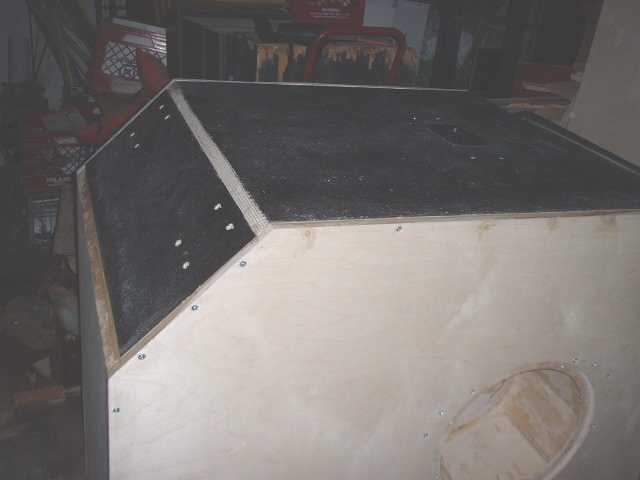

After the glue dries, paint the cabinet. Grab a gallon of truck bed liner and a course roller to provide the texture. The finish is easy to apply and very durable. Use an aerosol can to spray inner corners and other areas where the roller won't reach, then use the roller to cover the rest.
http://www.pispeakers.com/Basshorn/Cabinet_Completed_Diagonal_View.jpg
Finish applied
http://www.pispeakers.com/Basshorn/Cabinet_Completed_Side_View.jpg
Side view of finished cabinet
