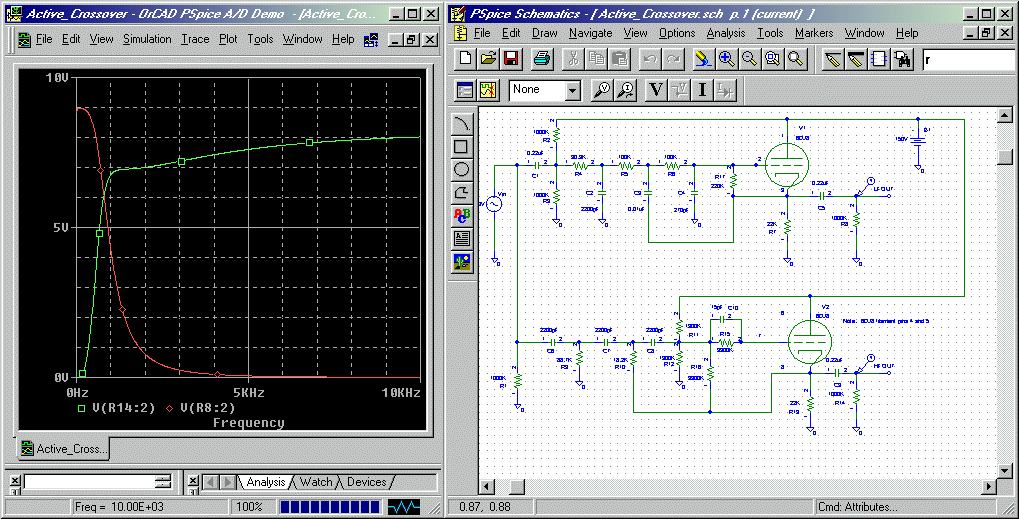

Active Crossover [message #45106 is a reply to message #45103] Thu, 29 July 2004 08:13 Go to previous messageGo to next message
I can offer only a model of an active crossover that implements the same EQ as the passive π crossover. The model is made for PSpice and is based on the Steve Bench active crossover. Circuit boards are available.
http://www.pispeakers.com/Tube_Crossover.gif
Active implementation of π compensated crossover using 6DJ8 tube
Re: Active Crossover [message #45111 is a reply to message #45106] Thu, 29 July 2004 08:30 Go to previous messageGo to next message
Yury is currently offline  Yury
Messages: 52
Location: Kiev, Ukraine
oh! I see. but this is unregulated version. it's ok. but me and other maybe has interest for regulate cutoff frequency, phase, level output signal.... more interesting will be for low freq output which is a difference between stereo output (filtered) and stereo input. I mean stereo output is from 80 hz to inf, and sub chanal is from 0 to 80 hz.

Re: Active Crossover [message #45115 is a reply to message #45111] Thu, 29 July 2004 09:06 Go to previous message
Good story.
You're right that there are no external adjustment knobs on this crossover. You set crossover frequencies by changing components. I suppose you could make it switch selectable between a few set frequencies though. That's one thing about building your own. You can pretty much make whatever you want.
