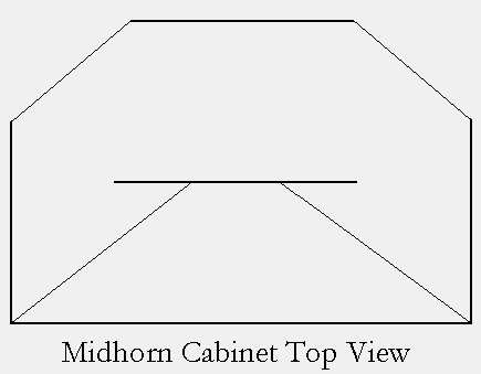

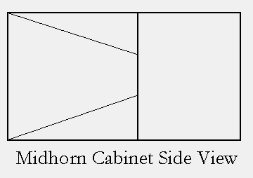

Cabinets [message #44368 is a reply to message #44366] Mon, 12 April 2004 01:02 Go to previous messageGo to next message
Cabinets
Some of the places where this horn will be used are on top of π cornerhorns, Klipschorns and Klipschorn clones and other speaker systems where a high-quality full-vocal-range horn is required. Some of the intended cabinet designs are shown below, and of course, many others are possible.
http://www.pispeakers.com/Midhorn_cabinet_top_view.gif
http://www.pispeakers.com/Midhorn_cabinet_side_view.gif
A simplified midhorn cabinet is shown above. The horn is enclosed in a cabinet, and the rear chamber is lined with R13 or other suitable absorbent stuffing material. The size and shape is arbitrary, as long as the rear chamber exceeds 0.35ft3; It just needs to be big enough to surround the driver and that's all. Since the horn is often used on cornerhorns, it makes sense to have a shape that is suitable, so trapezoids and shapes like shown above might be better than rectangular cabinets. But it is really a matter of aesthetics.

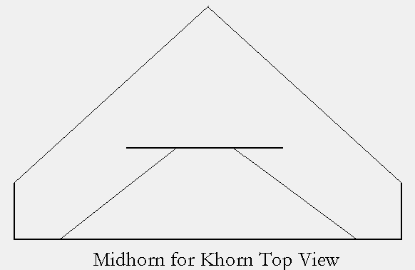

A version of the cabinet can be made to fit Klipschorns and Klipschorn clones. The dimensions are shown below.
http://www.pispeakers.com/Khorn_top.gif
http://www.pispeakers.com/Midhorn_cabinet_for_Khorn_top_view.gif
As I mentioned earlier, we plan to offer this horn as a completed assembly and as a flat-pack kit. Prices aren't set yet, but we'll do that pretty soon and add them to the shopping cart. I think they'll be something like $100.00 each for basic MDF and $150-$200 for various fine woods. Flat pack kits make assembly easy, since they are already cut-out and ready to assemble. We also have the drivers in stock and our prices are competitive, cheaper than Parts Express and places like that.
