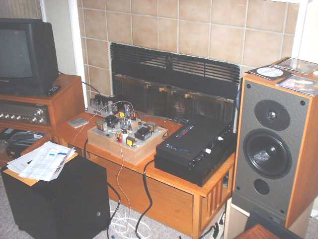

In attendance was Jim Denton, Akhilesh Bajaj, Bob Russell, Phil Wilson, Bill Wassilak and me. We listened to two single-driver speaker systems, both based on the Fostex 206e. One was designed by Martin King and built by Jim Denton and the other was Phil Wilson's speakers, which are a finished product sold by David Dicks in St. Louis. We also compared three amplifiers, a vintage Pilot amp, a Zen Select and Paramours. The Paramours were run using the stock entry-level Valve Art 2A3 tubes as well as with Electro-Harmonix 2A3's.

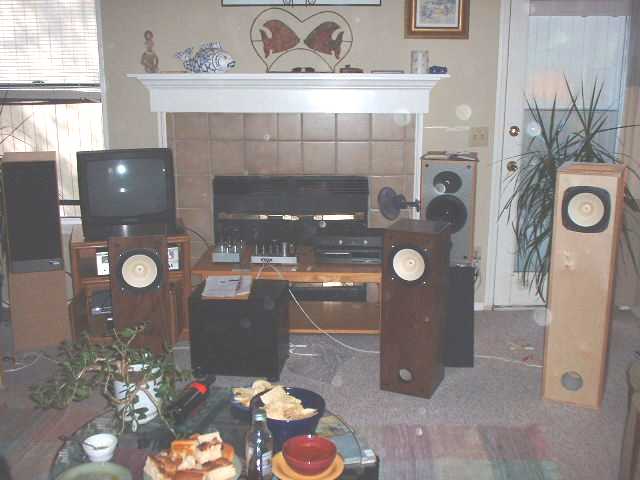

Here you can see the setup. The speakers on the outside are Martin King designs built by Jim Denton. The inner speakers are the David Dicks models owned by Phil Wilson. Both speakers have Fostex 206e drivers and no additional electrical components, whatsoever.
As you might expect, the two speaker systems sounded very similar. Both are excellent, in my opinion, and neither lacked in bass or treble. The larger Martin designs had a little more and deeper bass, but not loads more. Neither design was boomy, both sounded nice.

We listened to each amplifier with both sets of speakers. They all sounded great, but I thought the Paramours really sounded best. The bass became much more full, making those little 8 inch full-rangers sound pretty big. The midrange and treble was nice with each of the amps, but the Paramours gave that extra power from the deeper bass response.
Back to the subject of additional passive electronics, the truth is that with the tube amplifiers used, the speakers all sounded really good as-is. Output impedance of a tube amp is a few ohms, and it has both a resistive and inductive component, since the output transformer is a coil. So different configurations of tube amps with different output transformers act like different filters having different values.
The Paramour's charatcteristics sound like it's just about what Martin King would have wanted for his BSC filter when used with an amp having zero output impedance. I think I personally would have enjoyed the sound of the Zen/Fostex system more if it had something like 2-6 ohms paralleled with maybe a millihenry or two as a series BSC. An amp with lower output impedance might have needed maybe double that much resistance. But the Paramours sounded just about right.
