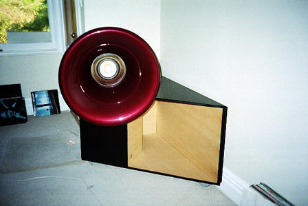

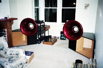

Re: Oris / π systems [message #41421 is a reply to message #41419] Sun, 18 May 2003 23:18 Go to previous messageGo to next message
I've just gotta say, those horns look great!
Pictures of your speakers are online at the π Speakers website at www.PiSpeakers.com/DIY/10Pi_Oris.jpg and www.PiSpeakers.com/DIY/10Pi_Oris_Shanko.jpg.
David Shank's Oris / ten π loudspeaker system
Re: Oris / π systems [message #41423 is a reply to message #41421] Mon, 19 May 2003 00:17 Go to previous messageGo to next message
Shanko is currently offline  Shanko
Messages: 15
Thanks Wayne!
To comment further on the initial question, I guess what I would do is figure out how much space I have, whether I could use corners, and generally figure out what was more important to me - efficiency/speed, or extension.
If bass depth and reasonable cabinet size are high priorities, the Lamda either Pi aligned or with PR's (per the post above) might be the best solution. If efficiency and integration is key, and the corners are usable, a Pi corner horn with the JBL's could be a good option. Or maybe the "chopped" 10Pi variant if the corners aren't great. It would be a good idea to try both drivers in a simple Pi aligned box to try and figure out which one worked for the space and intended top horn the best (mono would give a reasonable indication).
