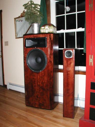

Towers [message #41144 is a reply to message #41143] Sun, 27 April 2003 14:41 Go to previous messageGo to next message
Bill, your cabinets are really great. I just love that look and I can hardly wait until they're done!!!
Check out John Lapaire's Theater four π speakers, which he made taller and narrower than the original, retaining the same volume and making a tower configuration.
John Lapaire's Theater four π tower speaker with MK2 beside it
Another interesting speaker is Martinelli's Arrezo, which is essentially a Theater Series three π in a tower configuration. It was a big hit at the Midwest Audiofest.

Re: Towers [message #41145 is a reply to message #41144] Sun, 27 April 2003 15:03 Go to previous messageGo to next message
wasteh202 is currently offline  wasteh202
Messages: 137
The driver mid/bass driver in the quasi Theater three barly fits the front baffle of the tower. Is there any issues with the baffle not being stiff enough? I like this tower design... one other question, the Theater three is not tube friendly... correct?
Re: Towers [message #41146 is a reply to message #41145] Sun, 27 April 2003 15:33 Go to previous messageGo to next message
In my experience, baffle step is not a problem for speakers that are boundary loaded anyway. There is only a small frequency interval between where the baffle acts as a boundary and the rear wall acts as a boundary. Since this range isn't sharply marked but rather a transitional area, it is essentially never realized. Besides, once you get down into the room's modal region, any effect of baffle step becomes swamped by room modes.
About the Delta 12LFA and tube amps, please understand that this is something that doesn't concern everyone, as impedance fluctuation isn't troublesome for every amp. Those that are considered "tube friendly" will work on even amps with very poor damping ability. But you'll find lots of tube amps that work just fine with practically every good-quality high-efficiency speaker. I was running Stage sevens and Bill was running his Arrezo's with tube amps throughout the show. Both sounded great, and produced nice deep bass with no audible artifacts or response anomalies.
