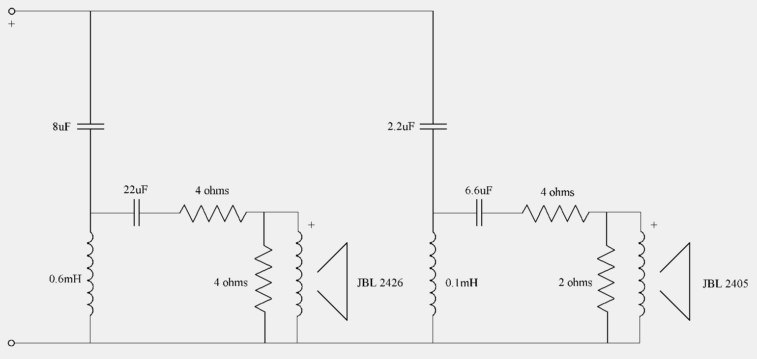

Question for Wayne [message #39194 is a reply to message #39186] Sun, 24 November 2002 05:51 Go to previous messageGo to next message
Garland is currently offline  Garland
Messages: 269
Wayne,
How would one add the JBL 2405 to the Theater 4's crossover? I'm afraid I need a bit of hand-holding on this. Is there anyway you could draw up a schematic? I recall a while back you spec'ed out a crossover for the Motorola 1038 with a pair o' resistors and pair o' caps. Would this be similar? and if I were to only want the super high freqs, say above 17or 18K could only a high pass filter be used on the 2405? If so what would an appropriate filter be?
Thanks!
Garland
2405 as top octave device. [message #39199 is a reply to message #39194] Sun, 24 November 2002 13:23 Go to previous message
Here's a crossover that will work nicely for you. Just replace the compression horn cable assembly and add the 2405 circuit.
