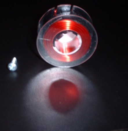

I took a moment to build a couple of loudspeakers with cable assemblies containing a 0.5mH coil, and to compare them with equivalent speakers having no coil installed.
0.5mH coil and mounting screw

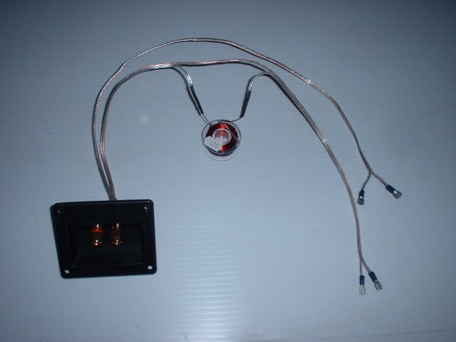

Cable assembly for one π amd two π Speakers
The cable assembly containing the 0.5mH coil can still be considered "crossoverless," because the coil doesn't act as a crossover at all. It merely adds inductance to the circuit, and phase is actually changed very little. As you can see from the response chart of the filter, no "crossover" function is performed - The coil merely attenuates midrange frequencies from 1KHz up, and this attenuation is almost perfectly linear. So those that prefer the simplicity of a "crossoverless" design might not feel their objectives defeated by deciding to install this part. It is still a minimal component design.

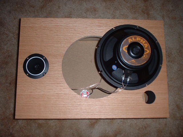

Installation of the coil, mounted on the bottom or rear panel
I found that the coil was best mounted using a small self-tapping screw on the rear or bottom panel. Do not place the coil directly behind the woofer - Offset it down or to one side instead.

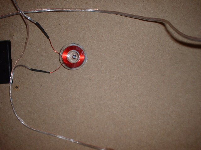

Connection of the various components
Connection is still very simple, with the wires from the coil going to the woofer and the straight wire going to the tweeter. Of course, positive goes to positive and negative to negative, on both the woofer and the tweeter.
