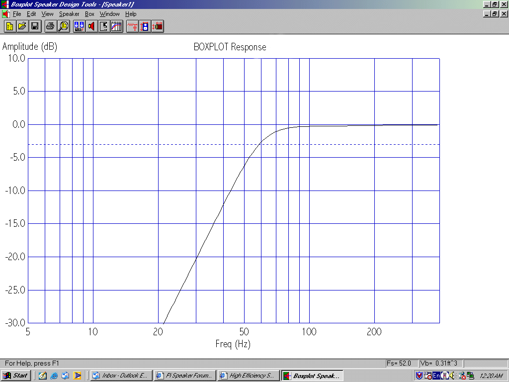

You've found an excellent motor for Scott's application. The system is optimally flat using this driver in a box the size needed, a quarter cubic foot. It's not terribly efficient, at 88dB/W/M. But that's normally the case with tiny woofers like this, and overall, it looks like one of the best solutions for the system.
From the Seas W18EX001 specification sheet, the numbers shown are Vas=37 liters (1.31 cubic feet), Fts=31.0Hz and Qts=0.24. PiAlign values are then Vad=1.31, Frd=31.0 and Qd=4.17 and the recommended enclosure is 0.31 cubic feet and tuned to 48Hz. It is able to calculate a cabinet having actual resonance very close to this - 52Hz - using a 3/4" port that's 3/4" long, so that nice because it can be formed easily by drilling a 3/4" hole in 3/4" baffle material. All-in-all, PiAlign's recommendation is an excellent solution.

Response graph of PiAlign'ed W18EX001 [message #37092 is a reply to message #37091] Wed, 26 June 2002 21:36 Go to previous messageGo to next message
Cabinet volume = 0.31 cubic feet
Port = 3/4" diameter hole drilled through 3/4" thick baffle
