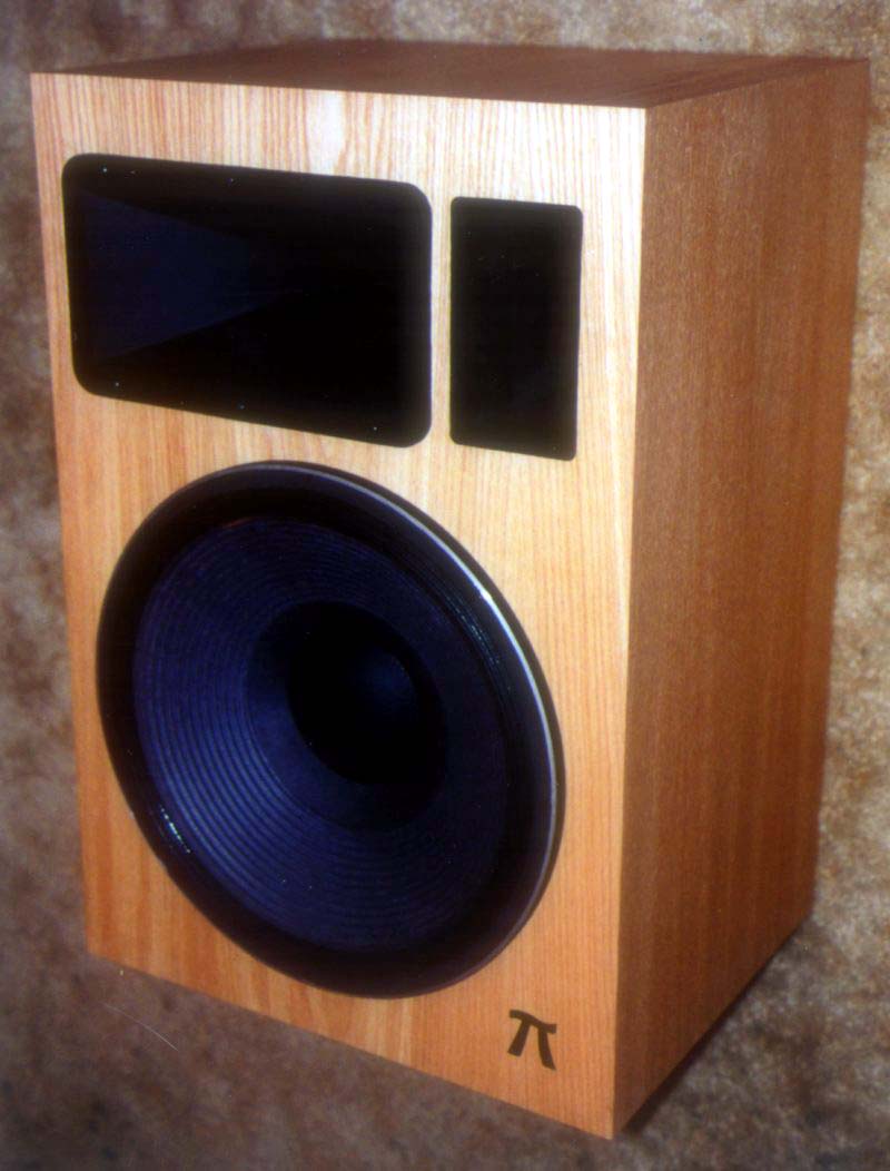

The port is 3.5" x 6" x 10" long, and it really has to be that for everything to fit. You can see in the photo below that there isn't a lot of room on the baffle. The port just fits, and it looks pretty good like that to me. The downside is that forces the tweeter to be horizontally offset a little bit, which in turn shifts the vertical coverage angle slightly towards a diagonal. But the null angle is wide, so this is of little consequence.

Here is the Pic.....
