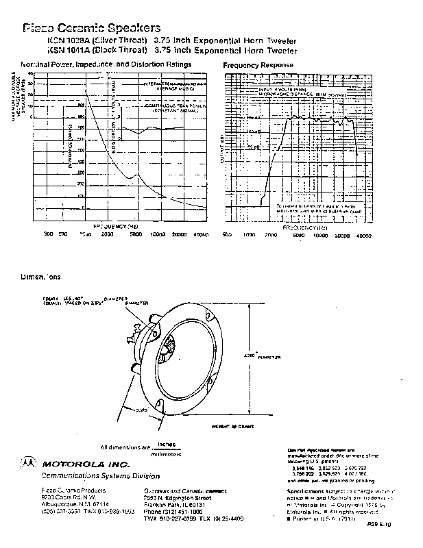

You mentioned piezo's, and so I grabbed a moment to post a spec sheet. The specs for the KSN 1038, 1041 and 1056 are shown above. Pay particular attention to the frequency response curve and distortion specs - the response is quite linear and distortion at 4v is only about 1%. So even though it's a "cheapie" - its performance is good. It isn't the same as the screw-on units, but thought you might be interested in the data sheet anyway.

A Piezo can be quite good - I wouldn't worry about the rising Z using with a tube amp IF its a speaker without an xover on the woofer but has a 'Zoebel" conjugate network on that woofer - then the overall Z seen will be ~ that of the woofer plus conjugate in he xover region.
I might want a small resistor in series with the piezo in case the amp doesn't like capacitive loads at HF - what value of series do you suggest? (I think~2 ohm ok without much loss)

In this case, a capacitive load, series resistance will act as a low pass filter since the motor's impedance at high frequencies is so much lower than it is at low frequencies. In the top octave, the tweeter's impedance gets smaller and smaller, so the voltage divider becomes more and more proportioned towards the series resistance. Still, if the series resistance is small enough, it won't adversely affect performance and will protect the system from very high frequency oscillation.
I used to connect 1 ohm, 1/4 watt resistors in series - just for this purpose. It acted as a fuse. And I think two ohms is just as appropriate as one. I don't install this component anymore, but there is no harm in it - and it most certainly does provide protection from UHF oscillation. The only reason I stopped is that I've never blown a quartz tweeter, nor have I ever found an amp that oscillated because of one. But that doesn't mean they can't be blown or that a person can't find an amp that will oscillate from this load. And the tiny added resistance may improve such a situation.

Perhaps UHF was your problem. Above 30kHz, the impedance of the piezoelectric tweeter drops to almost nothing. But they do produce sound at very high frequency which is why you'll occasionally see devices like bug repellants with piezo's in them - they're running them way up high like that. You can see from the response chart in earlier posts, that these drivers have a peak around 27kHz. But they don't handle much power there.
