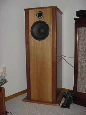

I don't know anything about woodworking, but wanted to point at the attractive two-tone finish on Jerrod's speakers.
Jerrod, Bill E. and Bill M. have done tons of this kind of stuff, so they can comment further.
