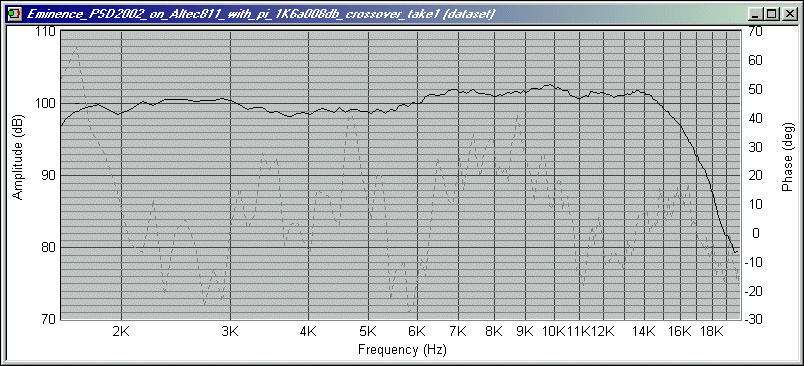

How's this for smooth... Altec 811-B with Eminence PSD2002 and Pi crossover.

Down 10db at 18k? Is this with or w/out HF comp?

There is almost no musical information at 18 khz, especially since most adults can't hear over 15 khz anyway. And that is a pretty good range for a driver/horn combo.

That graph is with that crossover, which has high freq comp.

Yeah, I guess you're right, I was just kind of surprised it rolled off like that. I do think that upper stuff lends a sense of air and openness, but no real information there.
