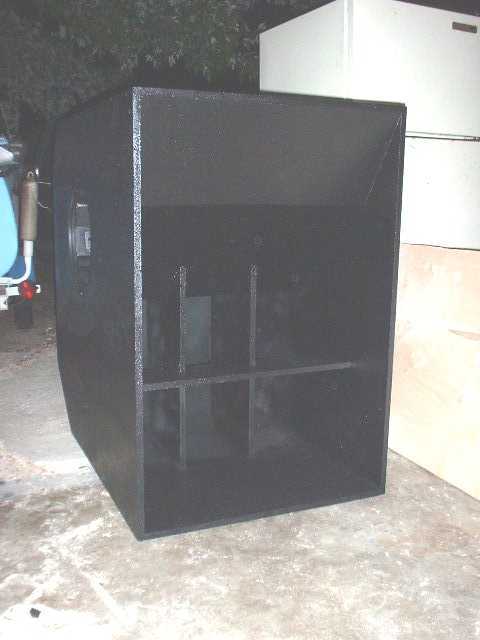

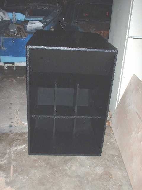

After the glue dries, paint the cabinet. Grab a gallon of truck bed liner and a course roller to provide the texture. The finish is easy to apply and very durable. Use an aerosol can to spray inner corners and other areas where the roller won't reach, then use the roller to cover the rest.
Finish applied
Side view of finished cabinet
Ready for the drivers and heat exchanger
Front View

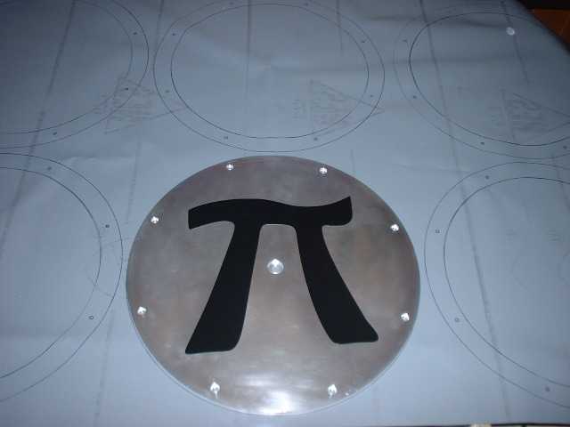

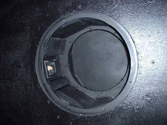

Use sheets of rubber or plastic for gasket material. The plastic used for making shower pans works well. Use the heat exchanger / access panel as a template and draw out a pattern, then cut it out with scissors and a hole punch.
Drawing gasket outline, using access panel as a template
Cut gasket with scissors and a hole punch

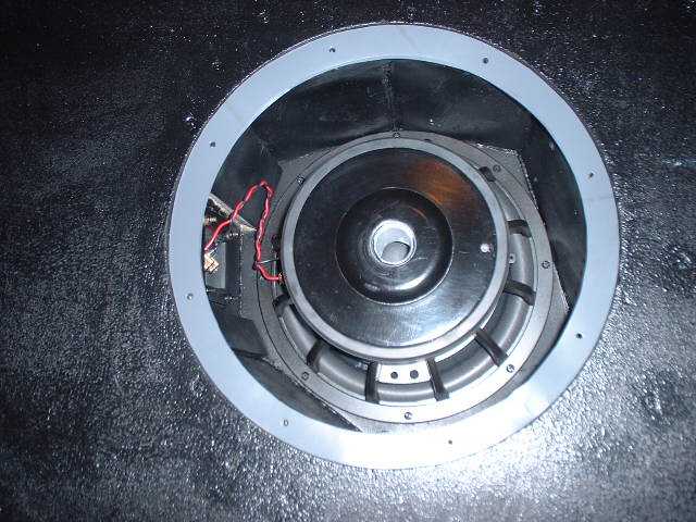

Before instaling the woofers, remove the protective mesh from the cooling vents. It is just pressed in, and comes out very easily. A small screwdriver can be used to pry it out. Lightly sand the paint from the vent with very fine 400 or 600 grit sandpaper. You may have to remove a few burrs in the metal on some woofers. Then clean the area with a paper towel and apply heat conductive grease.
Heat conductive grease in woofer vent

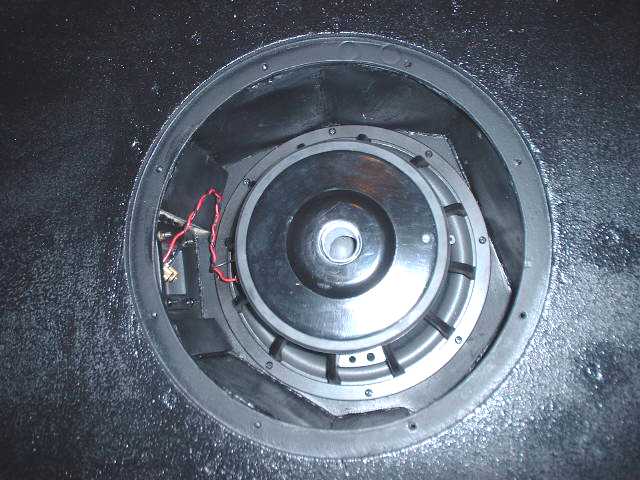

Install the woofers and connect them to the internal connector panels. It's a good idea to check the polarity of each woofer from the rear panel using a 9 volt battery. With the battery "+" connected to the input connector "+", both woofers should move towards the front chamber and throat. That means one will move outward and the other will move inward.
Woofers installed
Gaskets in place

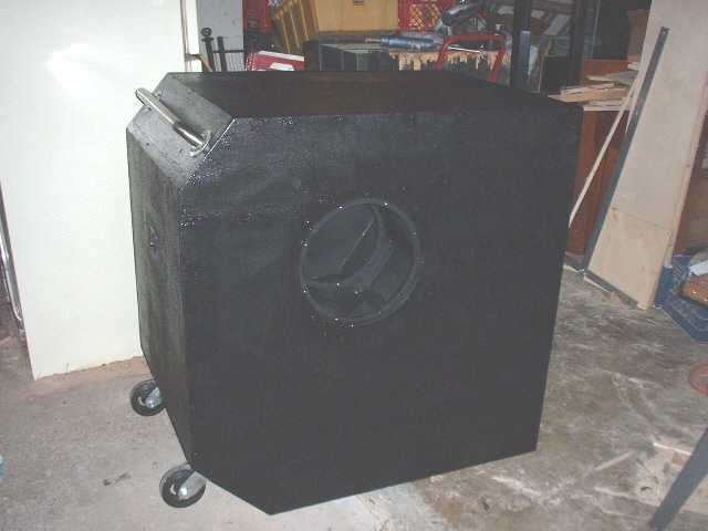

Install the heat exchanger / access panels and you're done!
12 π basshorn subwoofer, side view
12 π basshorn subwoofer, front view
