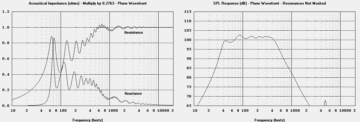

Are basshorns really horns or are they tuned pipes?
I've always considered bass horns to be resonant devices because of their size. Devices that are small enough to be portable resemble tuned pipes more than horns, in my opinion. A resonator is purely resistive at resonance. So is a horn in its passband, but over a greater bandwidth and for a different set of reasons.
I'm not sure it matters, since basshorns are usually only used for an octave or an octave and a half. But I wonder whether it is more appropriate to consider basshorns to be transmission lines or tuned pipes.
http://www.pispeakers.com/hornresp.gif
Typical basshorn acoustic impedance and response
Below 100Hz, impedance shown above is highly reactive. It acts very much like a tuned pipe.

I've often said that most basshorns are too small to be true horns. I've observed that the reactance measurements show them to act like tuned pipes in the region they're used in. The mouth area is small, and the impedance curve is peaky. It just looks more like a resonator than a horn to me.
Maybe this feature should be embraced. Maybe when the device must be made physically small, the best approach would be to try to align the system like a tapered pipe, where driver position in the line is used to set standing wave modes for smoothest response. Seems like a good idea to me.

The acoustic impedance of horns becomes resistive as frequency rises, but at low frequency, they are reactive. They appear to act more like tuned pipes down low, and even more so if the mouth is undersized such as is usually the case with basshorns. That, combined with the fact that a basshorn is usually crossed over before acoustic impedance becomes uniformly resistive, brings me to the conclusion that a basshorn acts more like a tuned pipe.
One possible design approach is to embrace this instead of trying to overcome it. Some liken a horn to a wide band resonator anyway. There is nothing particularly wrong with resonance, that's what bass-reflex uses, it's what transmission lines use, pipe organs, etc. Instead of expecting the device to act like a horn, maybe it's more appropriate to see it like a transmission line or tapered pipe. That's definitely what the impedance curve suggests for the first octave or two.
