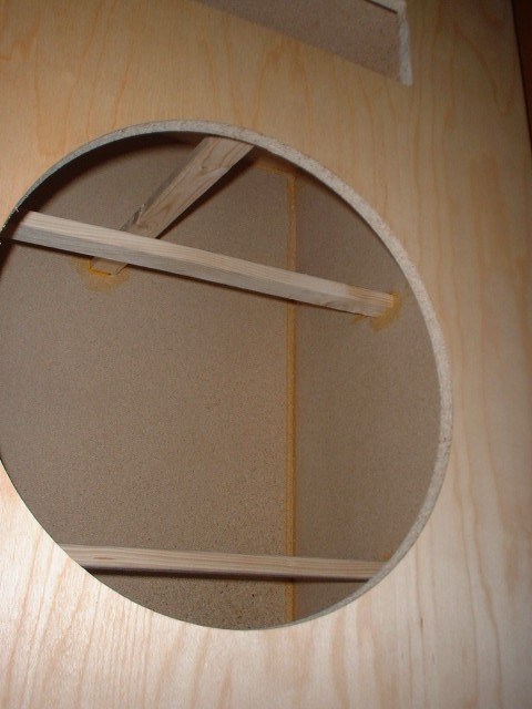

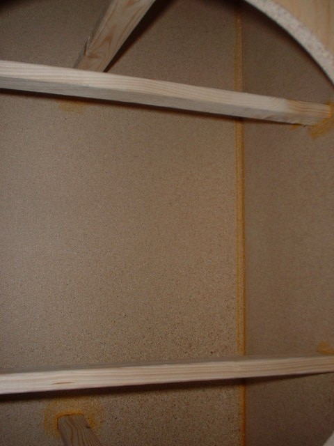

I've been assembling some Theater Series four π Speakers, and I took a moment to get a photograph of bracing. The plans all say "install bracing every 18 inches" and I commonly tell people to preload long panels by installing 1" x 2" braces between opposing sides. So here's a couple of photos that show them installed.
Photo showing hole for woofer, exposing braces
Moved in closer, showing two between the sides, and two from front to back
