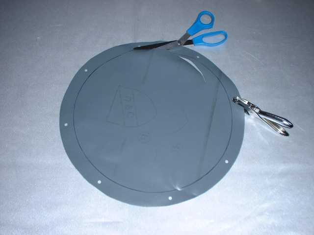

It's easy to make gaskets. Just draw an outline of the part with a pen, and also make a mark where mounting holes are.
Drawing an outline of the crossover PCB to make a gasket
Next, cut the gasket out and make holes for screws with a hole punch.
Cutting out a gasket

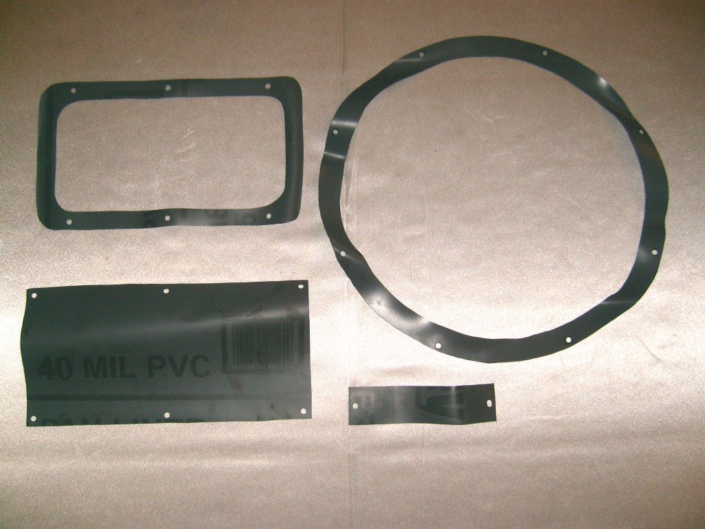

You can make gaskets for drivers, horns, crossover PCB's, Zobel resistors, access panels, whatever you need. It is very easy to do.
Gasket set for a four π loudspeaker
